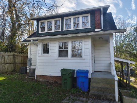

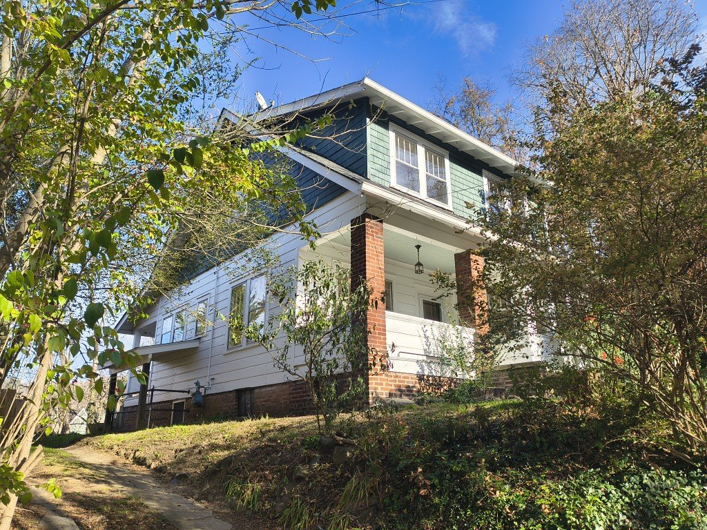

livninavl Posted January 15 Share Posted January 15 I am struggling with the roof on the attached plan. I know the little shed roof on the back of the main floor was an add on and I did not know if there was a way in the wall settings to get the roof to generate to match the attached images of the actual home. Would love it if someone could point me in the right direction. I have it close but the last little bit is killing me. Thanks in advance, Brian PS Using x17 Premier 1 Woodlawn Ave.caproj Link to comment Share on other sites More sharing options...
Mark3D Posted January 16 Share Posted January 16 I had a go at it , have a look at the file attached file might get you moving in the right direction I did auto roofs on lower story by moving upper story wall out of the way, then I put upper story walls back, then did manual roof on upper story but all manual roof would also work fine It's not correct as I would have to do too much guessing, so you should be able to edit and correct it 1 Woodlawn Ave As Built mark edit.plan 1 Link to comment Share on other sites More sharing options...

Mark3D Posted January 16 Share Posted January 16 To move forward I would set the roof pitches correctly, then use the transform replicate to adjust there heights and then hopefully everything will fall into place. If not ash question here Link to comment Share on other sites More sharing options...
