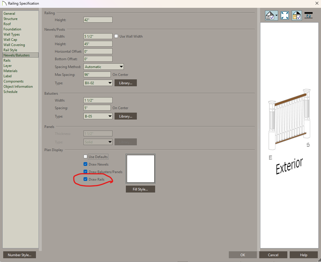

madcowscarnival Posted January 9 Share Posted January 9 Hope this is just a simple setting / toggle. My posts aren't displaying in plan view. They show up fine in ortho. Even changing to to something like a 10" post with a 2" beam (no hand rails or spindles), nothing shows up. I have a feeling that something happened when I was fiddling around trying to add a floor. But, I hadn't noticed until just now. The "framing, posts" is displayed; changing to "all on" still does not display them. If I go to a different plan, draw a railing, it displays posts like normal. Any help is appreciated. Thanks all. Link to comment Share on other sites More sharing options...
Renerabbitt Posted January 9 Share Posted January 9 2 minutes ago, madcowscarnival said: Hope this is just a simple setting / toggle. My posts aren't displaying in plan view. They show up fine in ortho. Even changing to to something like a 10" post with a 2" beam (no hand rails or spindles), nothing shows up. I have a feeling that something happened when I was fiddling around trying to add a floor. But, I hadn't noticed until just now. The "framing, posts" is displayed; changing to "all on" still does not display them. If I go to a different plan, draw a railing, it displays posts like normal. Any help is appreciated. Thanks all. uncheck this in your railing: Link to comment Share on other sites More sharing options...
madcowscarnival Posted January 9 Author Share Posted January 9 Thank you RR, that did it. It was set on default, which I must have somehow modified. Link to comment Share on other sites More sharing options...
