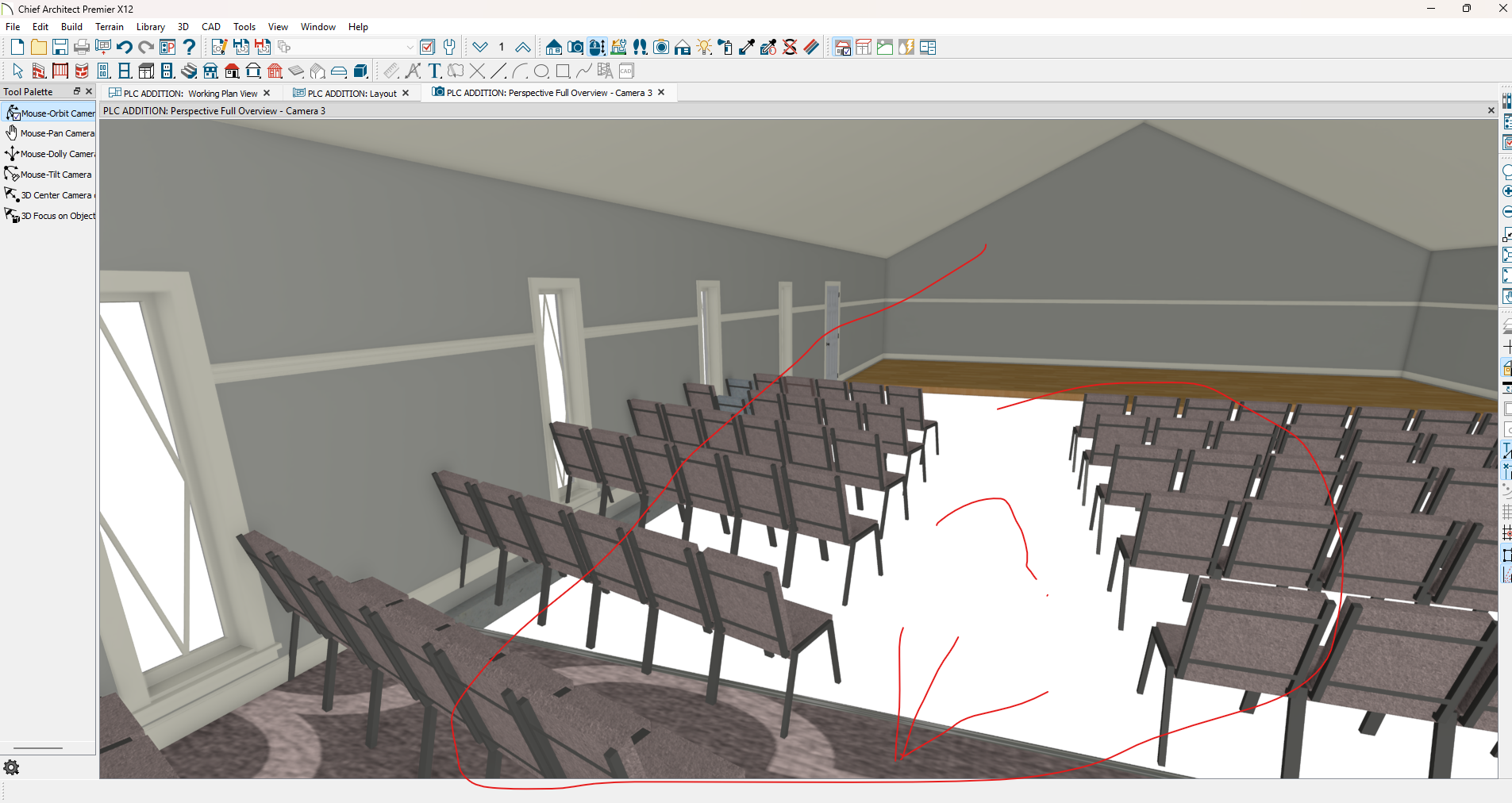

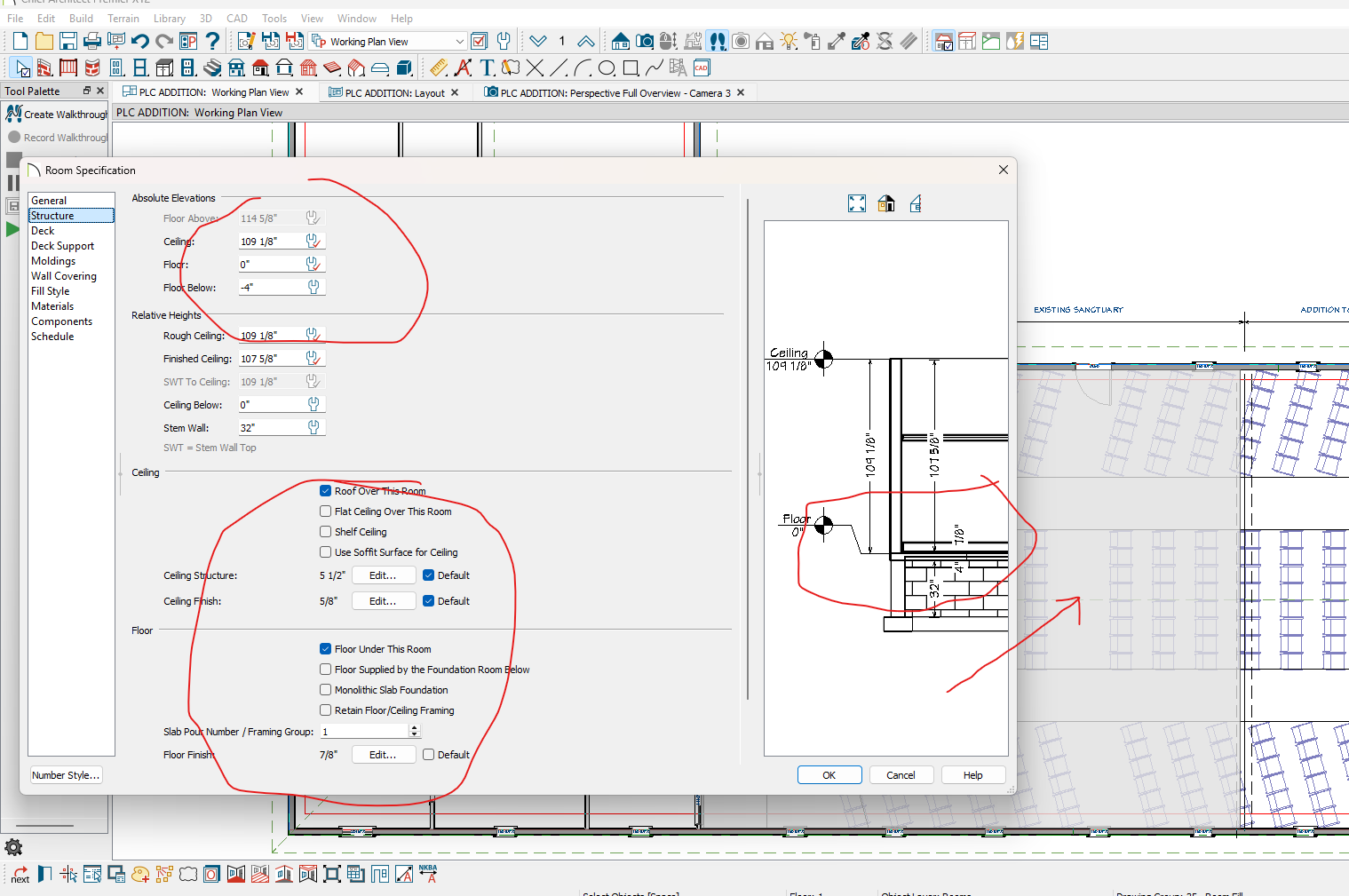

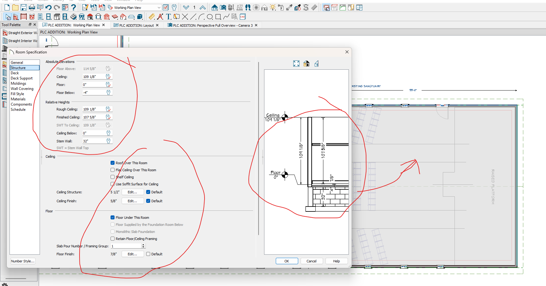

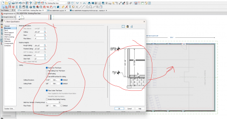

Evolution Posted December 30, 2025 Share Posted December 30, 2025 I've been trying to create a walk through, and in the process the floor in the area of the new expansion has suddenly vanished. I select the room of the existing sanctuary and open its dbx Then I select the sanctuary expansion (the room I created with a room divider: Both room dbx appear to be set the same, yet the floor in the sanctuary expansion has now vanished. With the presentation to the congrigation a little more than 24 hours away what in the sam hill is going on? Version X12. This is starting to bum me out! :-( The walls join properly because I can select each room together and independently. Link to comment Share on other sites More sharing options...
Evolution Posted December 30, 2025 Author Share Posted December 30, 2025 2 hours ago, Evolution said: I've been trying to create a walk through, and in the process the floor in the area of the new expansion has suddenly vanished. I select the room of the existing sanctuary and open its dbx Then I select the sanctuary expansion (the room I created with a room divider: Both room dbx appear to be set the same, yet the floor in the sanctuary expansion has now vanished. With the presentation to the congrigation a little more than 24 hours away what in the sam hill is going on? Version X12. This is starting to bum me out! :-( The walls join properly because I can select each room together and independently. I've tried so many different options to get the floor to come back. What am I missing? Plan attached. Can someone please help? PLC ADDITION.zip Link to comment Share on other sites More sharing options...
Solution PitMan71 Posted December 30, 2025 Solution Share Posted December 30, 2025 In the Rooms default settings, the function is set to "Open Below" Changing that should fix the floor disappearing. See your other post for an image showing you how to find that. Link to comment Share on other sites More sharing options...
Evolution Posted December 30, 2025 Author Share Posted December 30, 2025 20 minutes ago, PitMan71 said: In the Rooms default settings, the function is set to "Open Below" Changing that should fix the floor disappearing. See your other post for an image showing you how to find that. Shane, that was it. I forgot I copied a room def, then in define edit changed it to sanctuary expansion, dumb me set the function to open below.......what-a-twit?!?!?! Now on to the other issues. Link to comment Share on other sites More sharing options...
