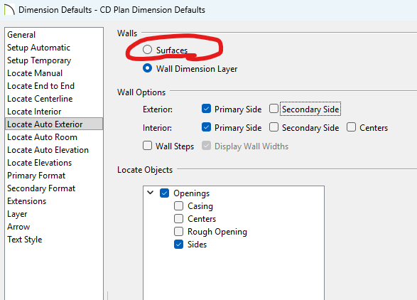

Michael_C Posted December 17, 2025 Share Posted December 17, 2025 Here is New Mexico we work with monolithic foundations. When creating a house plan and then build a foundation the auto dimension will snap to the outside of footing. How do I add the outside of wall (outside of monolithic pour) dimension? or just have it auto snap to the building wall only? Link to comment Share on other sites More sharing options...

builtright3 Posted December 23, 2025 Share Posted December 23, 2025 On 12/17/2025 at 2:19 PM, Michael_C said: Here is New Mexico we work with monolithic foundations. When creating a house plan and then build a foundation the auto dimension will snap to the outside of footing. How do I add the outside of wall (outside of monolithic pour) dimension? or just have it auto snap to the building wall only? This is not a lot of information you are giving us but if you want the outside surface of the wall this is what you are looking for. You want to set the default for whatever plan you are in. IE, floor plan, electrical plan, roof plan... Link to comment Share on other sites More sharing options...
