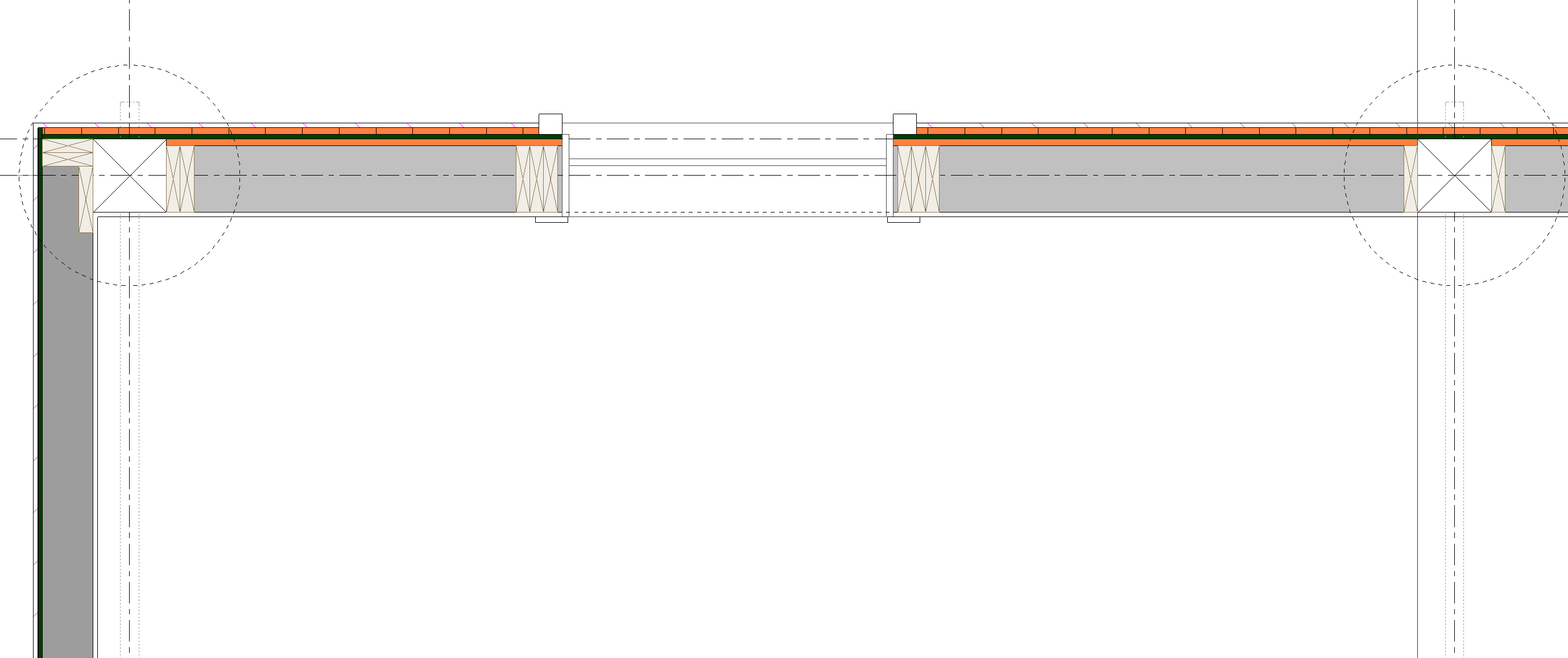

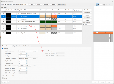

mtldesigns Posted December 16, 2025 Share Posted December 16, 2025 2 hours ago, Fotis1960 said: How do I create this wall? A couple of questions for you. First, are you going to provide a wall framing detail showing the studs OC dims? And are you going to run a report for materials and cut list? Are these post a true 6x6 or are the 5-1/2 x 5-1/2? I asked this because I did have a home where the post were a true 8x8s. That changed my approach some. The few I have done the builders could have cared less where I showed the studs, so I located my post per the spacing requirements, then I drew a wall, a normal wall right on top of it, with the post being centered with the framing. I am assuming the girts are on the outside of the post of your build which makes it a little different than what I had to do. With the post of mine being true 8x8s, I had to put girts inside the post to post to make up for the difference with the 7-1/4" wd studs. Builders Idea... and it seemed to work since their living in it now. On the second picture, you'll see I just placed my wall in-line with the post. I did place some "end view" of stud cad blocks in my floor plan, for understanding how I wanted this to frame without doing a framing plan. Also, you have to keep in mind the requirement for the kings and jacks framing at the windows and doors, so that was another reason I placed those stud end views. Hope this helps... Link to comment Share on other sites More sharing options...
