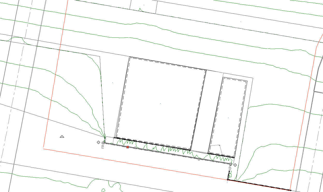

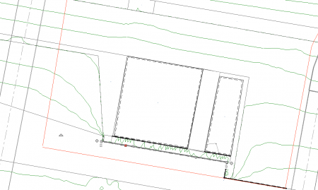

WW2Architect Posted December 12, 2025 Share Posted December 12, 2025 I've seen somewhat random results occur when building a terrain. I am using Elevation Regions as the results of creating elevation splines was, well, interesting to say the least. With my elevation zones I have several objects that represent flat areas, slabs and retaining walls. It seems I get random terrain lines when I execute the Build Terrain or Camera view. 1. I get a shark tooth effect on the high side of the retaining wall at 168" 2. I get a shark tooth effect on the low side of the wall that is also a slab is also a part of an elevation zone defined at 132 inches. 3. I see some random terrains in areas that I expect the grade to be consistent Finally, when I attempted using elevation splines and even when using zones I've got some random towers and wells in the terrain generation, wild elevations I know I didn't accidentally input. I could not find the root cause of these. I could only back out my updates until they disappeared. See attached image. PS. I've watched and followed the "Terrain and Site Plans: Learn the Basics" multiple times and in the video everything works perfectly. Seems that isn't always the case. PSS. Does anyone know a simple way to connect two splines together End-to-Start? When I was drawing the splines a few times I must have broken the link and couldn't find a way to get them to connect. Best regards. Peter Link to comment Share on other sites More sharing options...
Kbird1 Posted December 19, 2025 Share Posted December 19, 2025 On 12/13/2025 at 4:50 AM, WW2Architect said: With my elevation zones I have several objects that represent flat areas, slabs and retaining walls. It seems I get random terrain lines when I execute the Build Terrain or Camera view. 1. I get a shark tooth effect on the high side of the retaining wall at 168" 2. I get a shark tooth effect on the low side of the wall that is also a slab is also a part of an elevation zone defined at 132 inches. 3. I see some random terrains in areas that I expect the grade to be consistent 1 + 2 .....try putting a Terrain Break in the middle of the Retaining wall set to a 0" transition size, ie no slope - might need to move it a bit close to one side or the other to eliminate the jaggies/spikes 3. chief will automatically try and smooth terrains the best it can but sometime it's a bit like fight an old style waterbed, push down in one area and it will poup in another , chief used to have a vid on that too. Also make sure you don't ever let any of the elevation data, ie splines, regions, points touch each other , they will fight each other for control at that point causing spikes or dips etc. too help with that I make the line style for Elevastion Data orange and use a orange 95% fill in the regions which will show darker in in overlapping zones. PS you are better postings questions in the Q+A Forum and adding your .plan file if possible (14mb max) for people to look at and help out with. M. Link to comment Share on other sites More sharing options...
