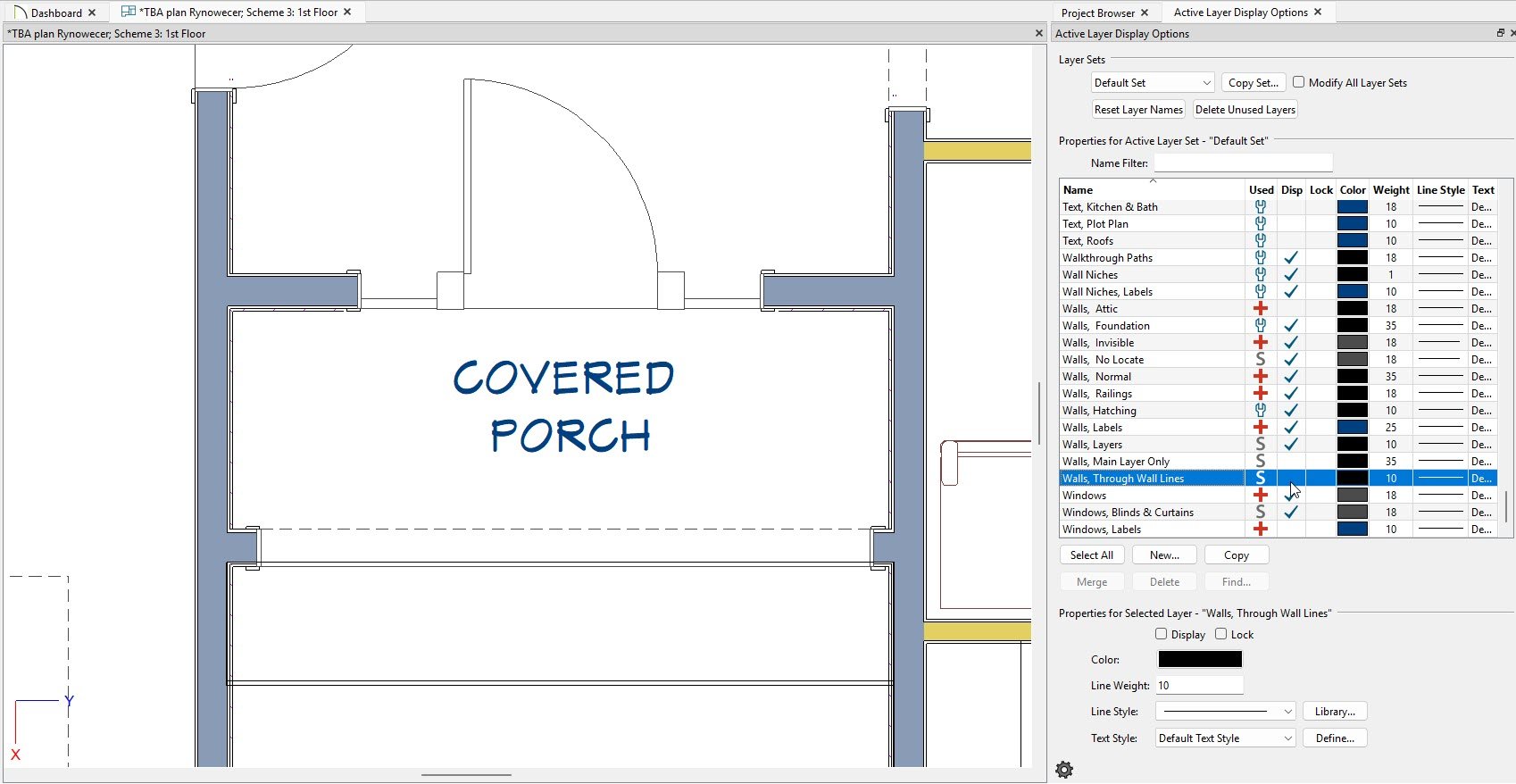

tbuck1db Posted December 9, 2025 Share Posted December 9, 2025 (edited) I imported this plan from a .DWG file and then used cad to walls to create the initial model. I can't figure out why each of the walls has a line at then end of it and is missing the siding layer. I've never seen it before and must have to do with the .DWG import and cad to walls function. Can anyone tell me how to fix those two items?TBA plan Rynowecer; Scheme 3.zip Using X17. TBA plan Rynowecer; Scheme 3.zip Edited December 9, 2025 by tbuck1db Link to comment Share on other sites More sharing options...
Solution ChiefTylerL Posted December 9, 2025 Solution Share Posted December 9, 2025 Hello @tbuck1db, in the attached plan you have both the Walls, Main Layer Only and the Walls, Through Wall Lines layers enabled which are going to control how your walls are displayed. To fix this: 1. Go to Tools> Layer Settings> Display Options 2. Find Walls, Main Layer Only and Walls, Through Wall Lines and turn these layers off 3. Click OK This should display your walls like you're used to. I hope this helps! Link to comment Share on other sites More sharing options...
tbuck1db Posted December 10, 2025 Author Share Posted December 10, 2025 Thank you! that took care of the siding layer displaying. I still have each wall separated by a line, and not continuous. Anyone have an idea for that? Link to comment Share on other sites More sharing options...
ChiefTylerL Posted December 10, 2025 Share Posted December 10, 2025 Based off of your description I think this should be the Walls, Through Wall Lines layer. Walls, Through Wall Lines layer enabled Walls, Through Wall Lines layer disabled Does turning this layer off fix those lines for you? If not, would you please attach an image of what you're seeing? Link to comment Share on other sites More sharing options...
tbuck1db Posted December 19, 2025 Author Share Posted December 19, 2025 Yes, gets rid of the lines at wall intersections, but I am still missing the wallboard lines. Link to comment Share on other sites More sharing options...
