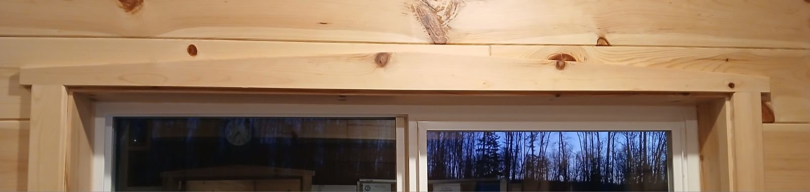

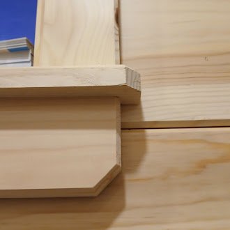

Does anyone know how to do either of these trim details- the arched top or the clipped corners- within the window specification instead of building the cases with 3d solids? That's how I've been doing it, and it does work, but is very time-consuming. Thanks!

You might be able to get something to work with the "exterior millwork" that you can put above or below the casing.  You might still have to jump through some hoops to get rid of the top/bottom of the casing though.  Might be easier to turn off the casing and just use a symbol for the whole trim.  If you setup the stretch plans, it should work for almost all of your windows.
