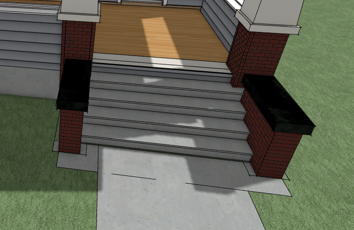

WW2Architect Posted November 29, 2025 Share Posted November 29, 2025 I've been trying to flare two end-to-end sidewalks. The situation is the path to the house has a flare (24") at the pedestrian sidewalk (S) and a flare (12") prior (E) to stair landing that go up to the porch. The width of the sidewalk is 74", the stairs are 116 1/4" wide and there is a narrow 22"x116 1/4" 'landing' at the bottom. Where the path and the landing meet the path is flared out. A few observations: The two slabs will not connect though I can force them to into a union. I cannot insert a break into the path. While the dialogue allows me to check flair at End it does not take affect. Both sidewalk objects are the same thickness and and terrain to top. I have tried to to Fillet the edges of the path which works but obviously isn't a flare. I am in Terrain Plan view when attempting these operations. I've run out of ideas. Link to comment Share on other sites More sharing options...
Joe_Carrick Posted November 29, 2025 Share Posted November 29, 2025 I'd use a "Polyline Sidewalk". That's much more editable, allowing breaks, fillets, etc. Link to comment Share on other sites More sharing options...
WW2Architect Posted November 29, 2025 Author Share Posted November 29, 2025 Thank you. That worked! Best regards. Link to comment Share on other sites More sharing options...
