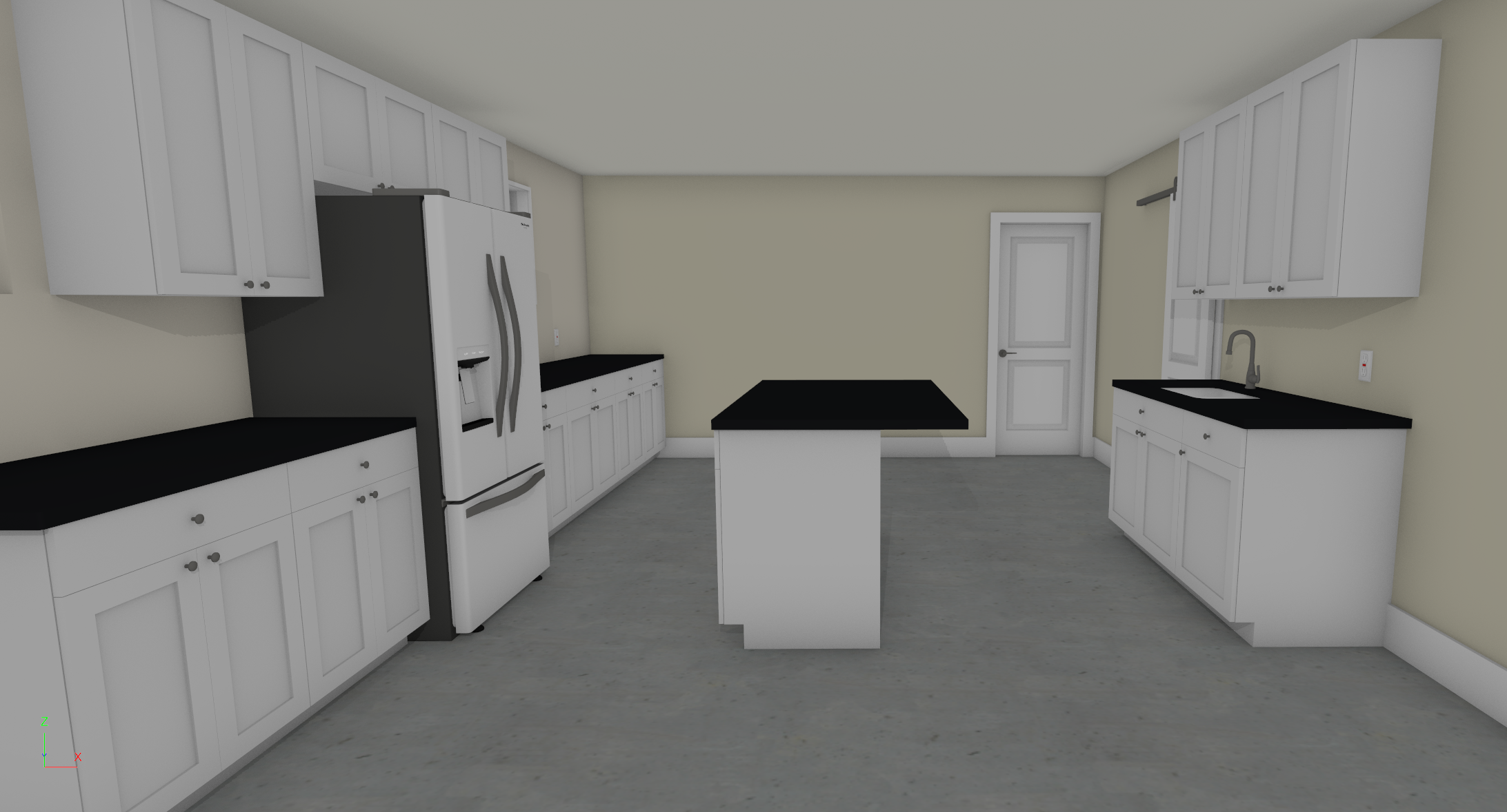

Solution DBCooper Posted November 29, 2025 Solution Share Posted November 29, 2025 1. Drywall shows up for me. Might not show up depending on the layer set you are using. 2. How did you add the molding polylines to the second floor? Did you draw them on the floor plan or in a camera view? If you drew them in the camera view, was your camera set to the 2nd floor when you drew them? I think the problem is that you somehow put the moldings on the first floor. You can probably move them to the second floor by using the "cut" edit tool, moving to the second floor and then using the "paste hold position" tool. You may or may not need to adjust the heights after doing this. Link to comment Share on other sites More sharing options...
