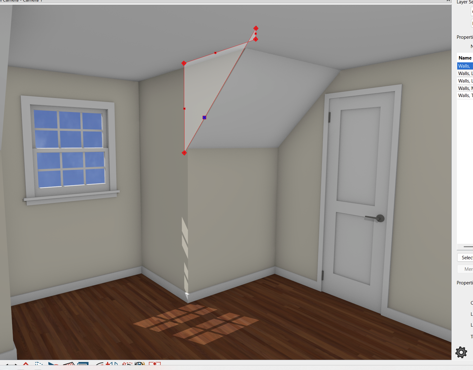

winterdd Posted November 19, 2025 Share Posted November 19, 2025 How do you guys fix this since I have never had luck drawing a wall and it letting me break it into the shape I need. If I do a pline solid and make it drywall material it won't show siding on the exterior. Is there a proper way to do this? Link to comment Share on other sites More sharing options...
Radius1 Posted November 19, 2025 Share Posted November 19, 2025 I draw a short attic wall. it should snap to the bottom of the roof. then in section view, adjust the bottom to match your rake. I'm sure there is a better way, but that seems to work for me rn. 1 Link to comment Share on other sites More sharing options...

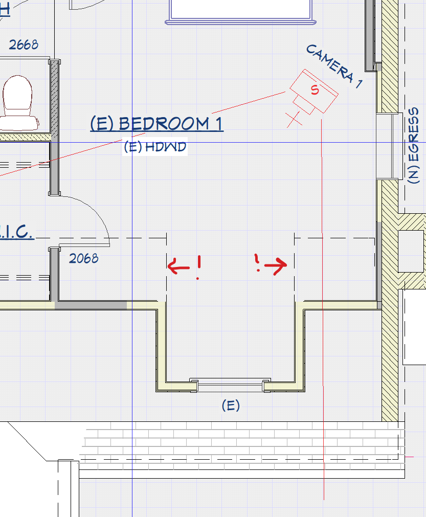

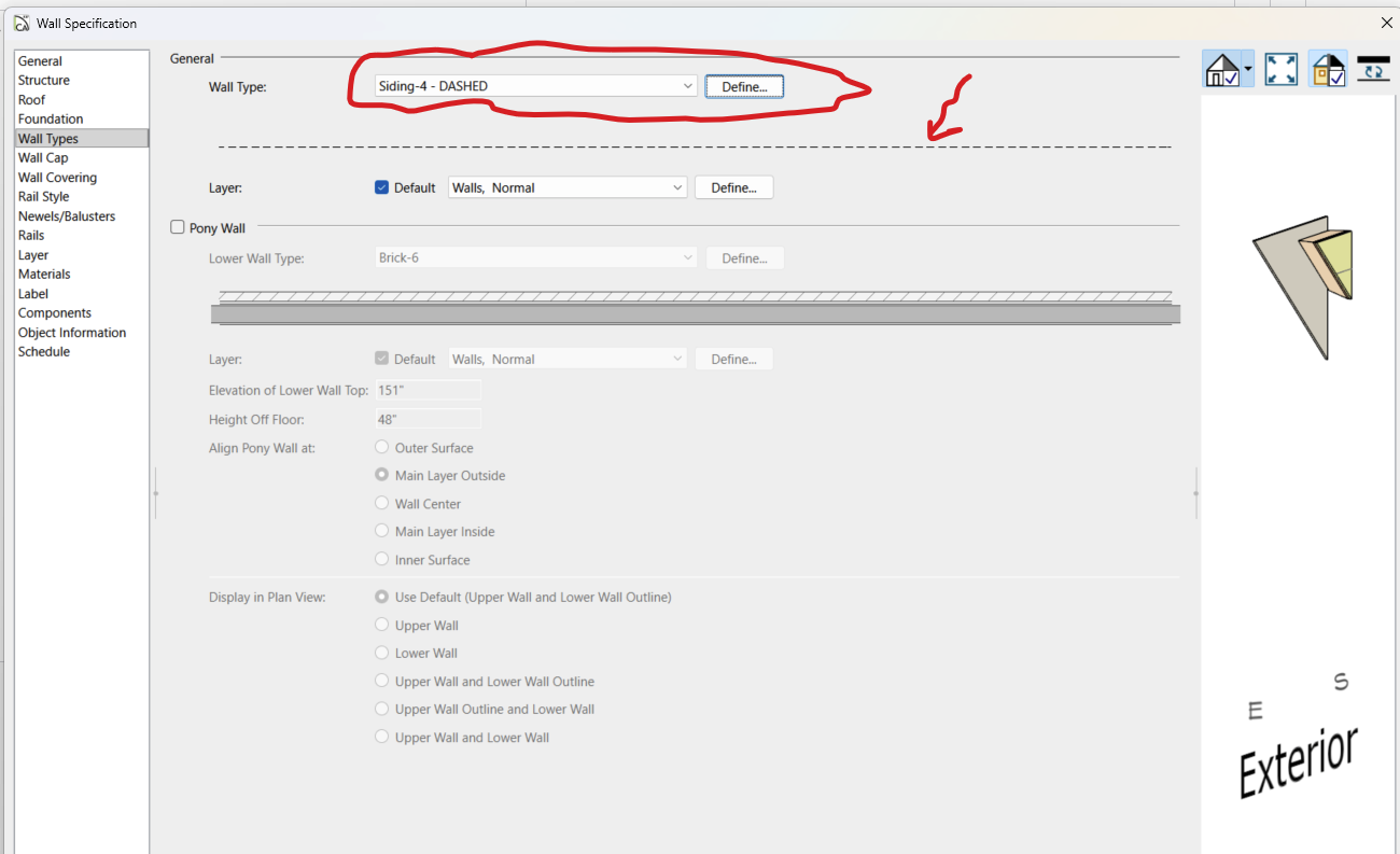

JKEdmo Posted November 19, 2025 Share Posted November 19, 2025 1 hour ago, winterdd said: How do you guys fix this since I have never had luck drawing a wall and it letting me break it into the shape I need. If I do a pline solid and make it drywall material it won't show siding on the exterior. Is there a proper way to do this? Rob, Here's my technique. I learned it off the forum or perhaps a Chief tutorial, so can't take credit. The diagonal segment is a separate exterior wall segment with "Roof Cuts Wall at Bottom" turned on: Then, I copy/ define it as a new wall type, say "Siding 4 - Dashed Above." Purpose of this is that the new wall type's plan display will be changed to show dashed line above in plan view. I set all layer fills to none and the linetype of the interior layer (drywall) to a dashed line: You can see the plan view result below with those diagonal wall segments dashed. They just about line up with the dashed ceiling break line running left/right in plan. Probably could be adjusted to line up exactly. - Jim 1 Link to comment Share on other sites More sharing options...
