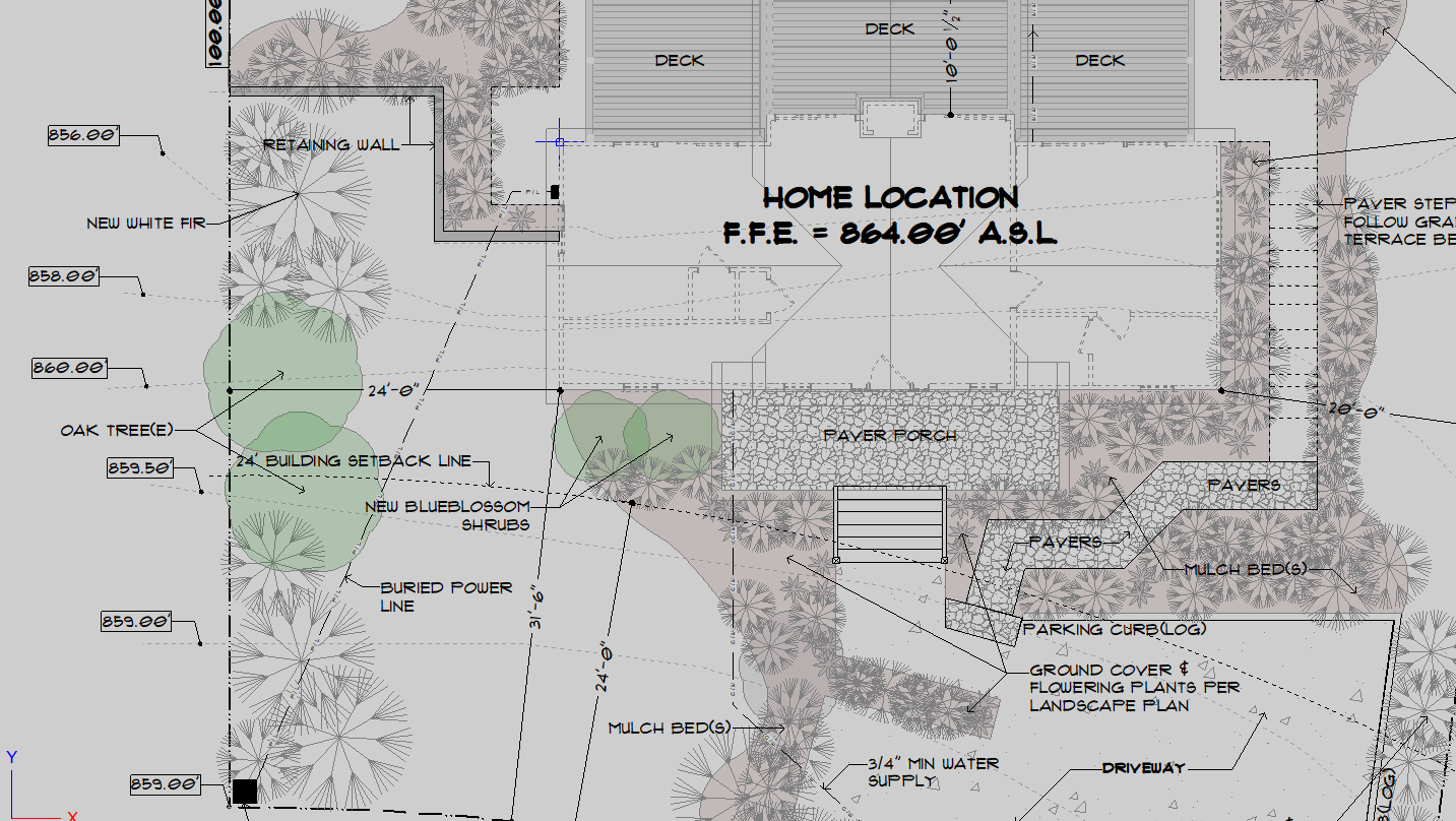

Merrittnew Posted November 3, 2025 Share Posted November 3, 2025 How can I reference the f.f. elevation with the same elevation on topo? Link to comment Share on other sites More sharing options...
joey_martin Posted November 5, 2025 Share Posted November 5, 2025 There is a video that will show you how to get the actual topo sea level numbers, but if there are a lot of them, I find it easier to simple label my topo lines and do the math. 1 Link to comment Share on other sites More sharing options...
joey_martin Posted November 5, 2025 Share Posted November 5, 2025 https://www.chiefarchitect.com/videos/watch/411/terrain-contours-absolute-elevations-vs-sea-level-elevations.html?playlist=101 1 Link to comment Share on other sites More sharing options...
