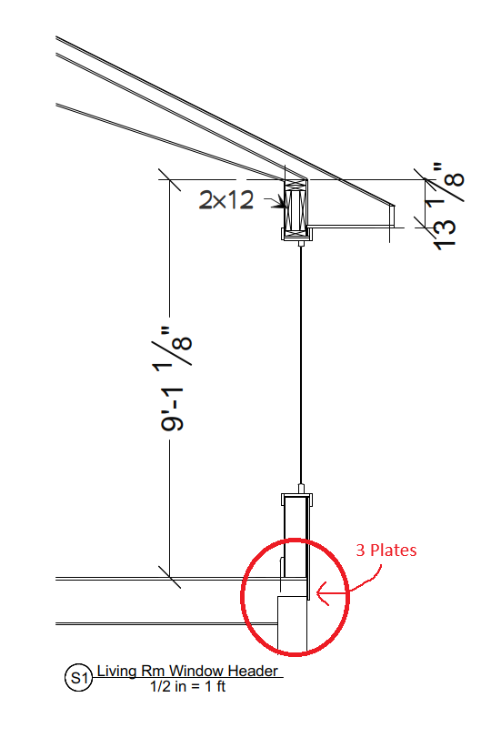

3DDesigner Posted November 3, 2025 Share Posted November 3, 2025 I have a project I'm on that is changing from the floor joists on top of the foundation wall to being hanging down in. But I need the top of the joists to be flush with the top of 3 plates. (See attached pic) Question 1: How to change my existing drawing without deleting floor 0 and starting over? I changed the defaults and did F12, but the drawing does not change. Question 2. How to show the 3 plates on top of the wall correctly? Link to comment Share on other sites More sharing options...
GeneDavis Posted November 3, 2025 Share Posted November 3, 2025 Why three? Is it to get your wall finish closer to grade? Link to comment Share on other sites More sharing options...
GeneDavis Posted November 3, 2025 Share Posted November 3, 2025 Did you see this? https://www.chiefarchitect.com/videos/watch/5202/creating-floor-platforms-that-hang-inside-walls.html?playlist=144 Try building with a 4-1/2" thickness mudsill and then editing it to a 3-stack after your framing is all the way you want it. 1 Link to comment Share on other sites More sharing options...
3DDesigner Posted November 4, 2025 Author Share Posted November 4, 2025 On 11/3/2025 at 10:13 AM, GeneDavis said: Why three? Is it to get your wall finish closer to grade? That is the request of the HVAC subs. With the floor system completely recessed, there is no way to get AC lines and some other services to the outside. That is commonly done here in Kansas. To go through the concrete wall makes a hole almost below grade. Link to comment Share on other sites More sharing options...
3DDesigner Posted November 4, 2025 Author Share Posted November 4, 2025 On 11/3/2025 at 10:28 AM, GeneDavis said: Did you see this? https://www.chiefarchitect.com/videos/watch/5202/creating-floor-platforms-that-hang-inside-walls.html?playlist=144 Try building with a 4-1/2" thickness mudsill and then editing it to a 3-stack after your framing is all the way you want it. Thank you Gene! That's what I needed - both the video and the tip Link to comment Share on other sites More sharing options...
