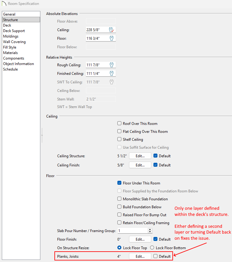

Migaloo Posted October 30, 2025 Share Posted October 30, 2025 Having an issue getting my deck framing to generate under my deck.CHIEF QUESTION DECKS.zip Link to comment Share on other sites More sharing options...
Migaloo Posted October 30, 2025 Author Share Posted October 30, 2025 I got it to build changing room type to balcony and then back to deck. ??? Link to comment Share on other sites More sharing options...
mLongChief Posted October 30, 2025 Share Posted October 30, 2025 1 hour ago, Migaloo said: Having an issue getting my deck framing to generate under my deck.CHIEF QUESTION DECKS.zip Looking at the problematic deck in question, it appears that the deck's Planks, Joists layers is set to a non-default setup of 4" of Redwood. With only one layer specified within the Planks, Joists structure, the deck is going to have problems, as it doesn't have 2 individual layers for the planks and joists. Either adding a second layer to the structure, or enabling Default to use the default layers should allow the deck framing to build properly (assuming your default Deck room has two layers defined as well). 47 minutes ago, Migaloo said: I got it to build changing room type to balcony and then back to deck. ??? Doing that looks like it turns that Default checkbox back on, adding back that second layer, so makes sense why that fixed the issue. 2 Link to comment Share on other sites More sharing options...
