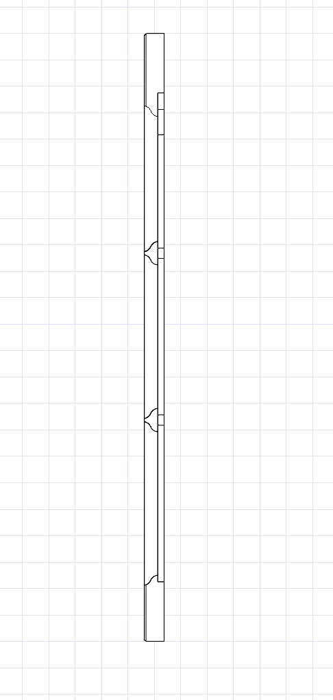

DJSSDB Posted October 30, 2025 Share Posted October 30, 2025 I need a profile view of a custom cabinet door for a shop drawing to show the sticking, like the door was cut in half. Probably in a 2d view capable of being dimensioned and sent to layout page. Is this a possibility? I saw an older post with a video that may be the answer, but the video is no longer available. I'm on X15 Link to comment Share on other sites More sharing options...
Solution DBCooper Posted October 30, 2025 Solution Share Posted October 30, 2025 Have you tried just using a cross section of the door by itself? If you need to make edits to the profile, you could always use the "cad detail from view" tool. Link to comment Share on other sites More sharing options...
DJSSDB Posted October 30, 2025 Author Share Posted October 30, 2025 Thanks DB, I ended up just drawing the profile. But this is way better! Thanks Link to comment Share on other sites More sharing options...
