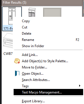

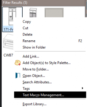

Renerabbitt Posted March 23 Share Posted March 23 I just found this thread searching for something else. You would have to right click on your library object and update it from the TMM: Link to comment Share on other sites More sharing options...
MollyNDG Posted March 23 Author Share Posted March 23 @Renerabbitt I have never noticed that option in that drop down, I will give it a go. Thank you! Link to comment Share on other sites More sharing options...
