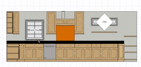

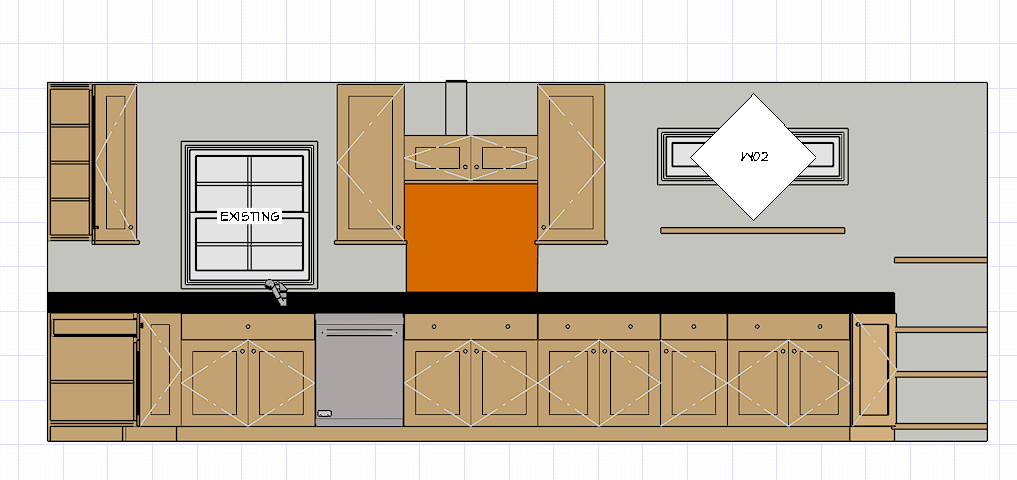

dhurst Posted October 27, 2025 Share Posted October 27, 2025 We have just introduced using window and door schedules on our drawings in lieu of our specifications. I set up my templates and everything appeared to be good until I chose to use them in a new templated. I have set my text to come in using my settings for 1/4" scale, but the callouts are 3-4 times larger than I want. I have "calculate from text" checked but can't figure it out. Any suggestions on additional settings I should check. Link to comment Share on other sites More sharing options...

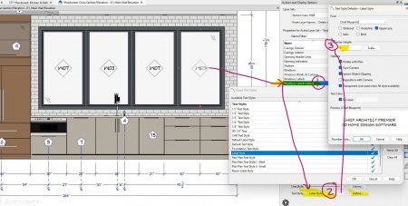

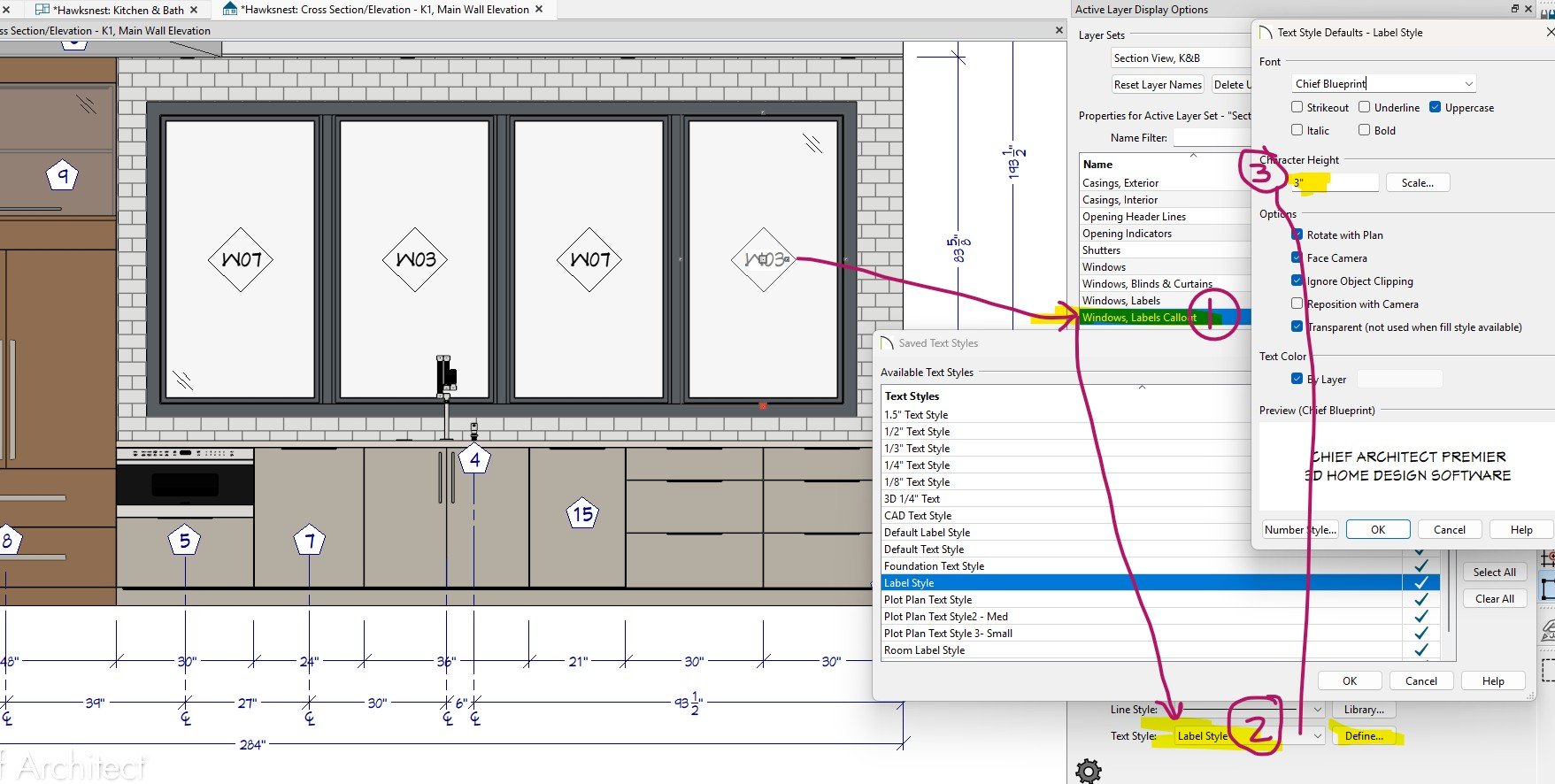

scottharris Posted October 28, 2025 Share Posted October 28, 2025 You might check what Text Style is used for the Label; then adjust it to your desired size. Link to comment Share on other sites More sharing options...
