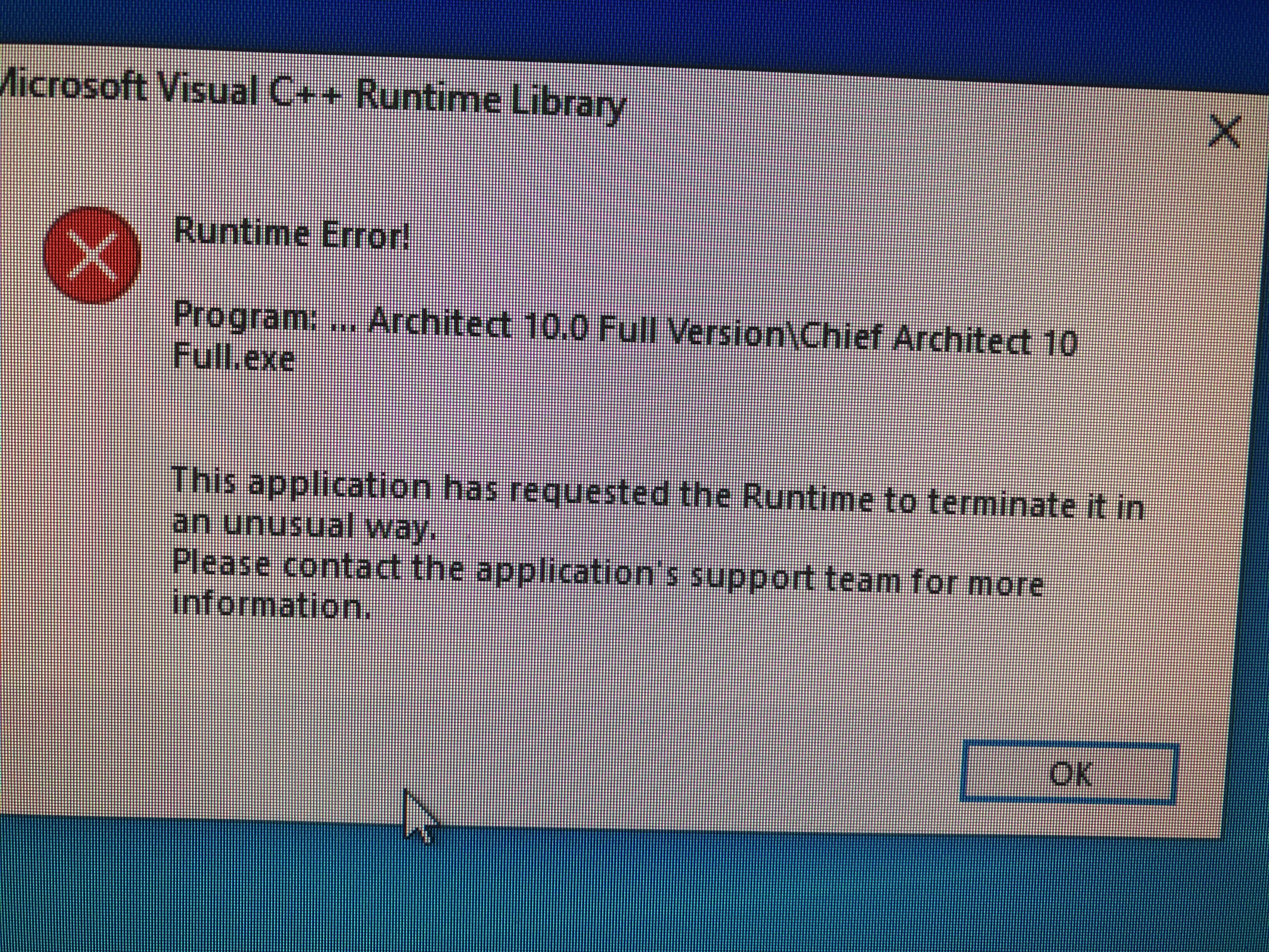

Jhrost Posted October 25, 2025 Author Share Posted October 25, 2025 Ok. Found it! It has no sticker but does say HASP on it. It is smaller that the 9.5 key. BUT same red light. Now when I run as administrator and enter the CD key, Windows 10, it says runtime error.... Working on that... Link to comment Share on other sites More sharing options...

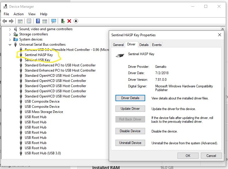

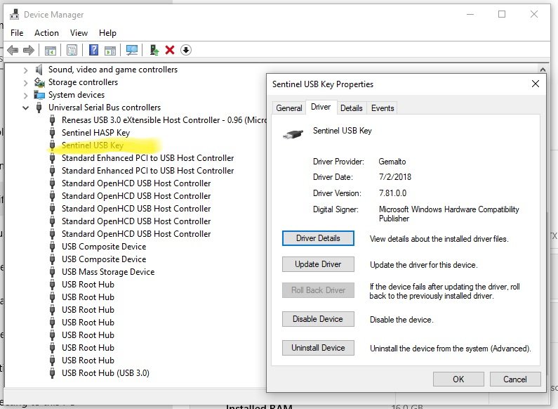

Bob_Medvetz Posted November 2, 2025 Share Posted November 2, 2025 I uploaded the drivers in the previous HASP not recognized. thread. Look at the second thread which states to download the files into a Sentinel folder. Those are the drivers that you need. I took screen shots for you of my Windows 10 configuration. Note that there are two separate drivers - HASP and USB Key 1 Link to comment Share on other sites More sharing options...
mthd97 Posted November 2, 2025 Share Posted November 2, 2025 (edited) Thank you very much Bob. Edited: I appreciate all your hard work to help us here Bob. Those drivers in the files you supplied in the other thread were certainly installed. I was testing it with my Lenovo ThinkPad X12 Windows 11 and home designer pro 7 with the red hasp key. Unfortunately I couldn’t get the HDP7 to work on this machine after putting in my code. I also tried it on my old HP Elite windows 10 pc and still couldn’t get it to work on that machine. The red light certainly turned on the hasp key for both devices and these drivers are indeed 7.80 as you have stated. (I removed all the other divers as you stipulated before installing the drivers supplied by you. That made the light in the hasp key turn off.) I get 3 entries related to hasp key installing in the device manger. Those two above that you have highlighted in yellow above as well as a third one called “HL key”. I am sure there is still a way to get it work but it might be that I have to install those drivers separately and manually ? That is what I had to do to get my older programs (V10 and prior) to work on a new XP64 bit pro machine that I bought off eBay Australia a couple years back. I am still not giving up yet to get them to work on a newer machine like you have successfully done. All good fun ! Edited November 3, 2025 by mthd97 Link to comment Share on other sites More sharing options...

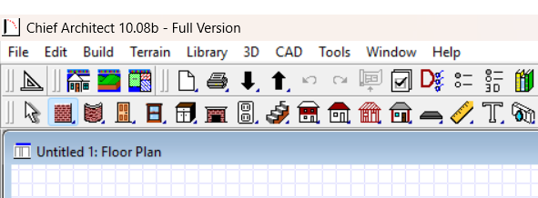

Bob_Medvetz Posted November 4, 2025 Share Posted November 4, 2025 I noticed that the screen shot says Architect 10.0 Full. It should be 10.08b. There was/is an update that you have to install for the HASP to work. It is 10.08. See attached screen shot for version. Link to comment Share on other sites More sharing options...

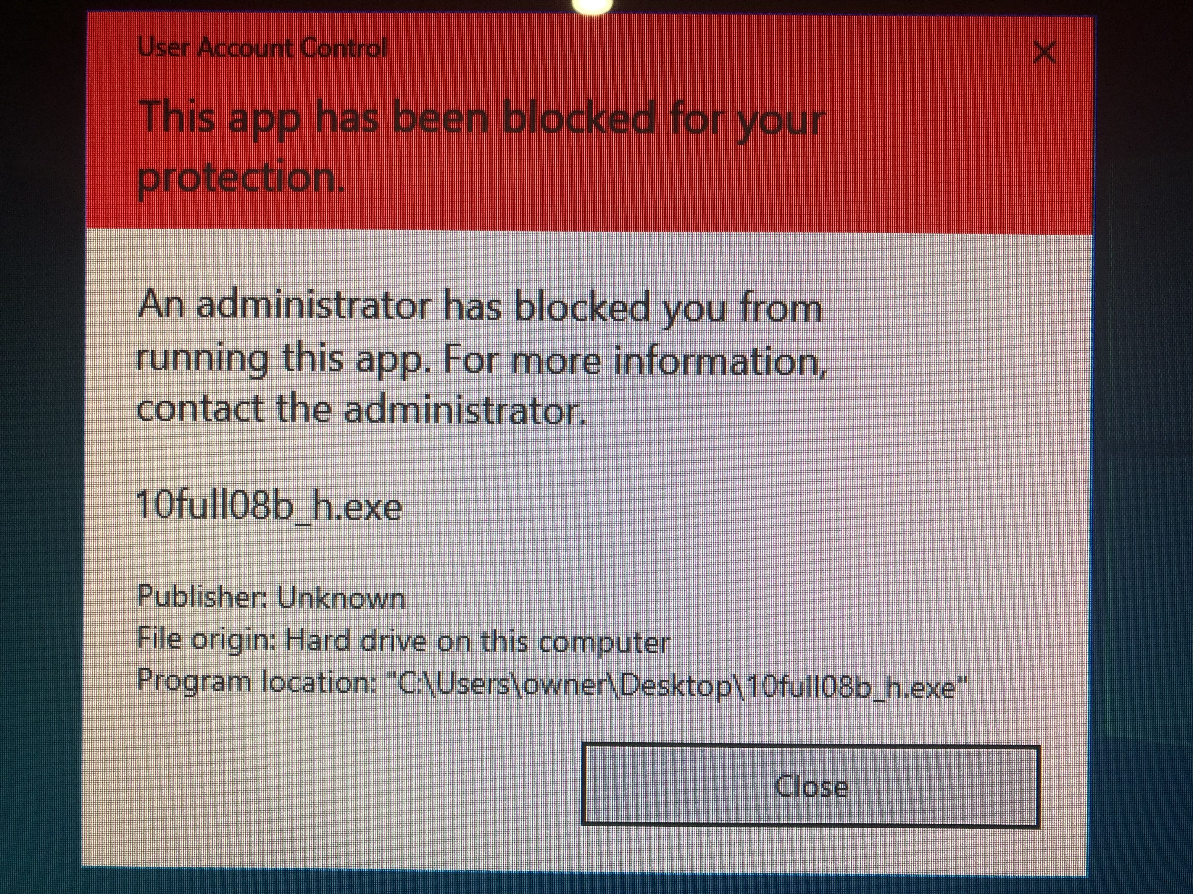

mthd97 Posted November 5, 2025 Share Posted November 5, 2025 (edited) 7 hours ago, Bob_Medvetz said: I noticed that the screen shot says Architect 10.0 Full. It should be 10.08b. There was/is an update that you have to install for the HASP to work. It is 10.08. See attached screen shot for version. I was wondering if that would affect it ? I will update it and try again and hopefully it will work. Edit: I tried but I get this message below even though I am the administrator of my pc’s. Anyway around this ? Edited November 5, 2025 by mthd97 Link to comment Share on other sites More sharing options...
Bob_Medvetz Posted November 5, 2025 Share Posted November 5, 2025 Watch this YouTube video. Method 2 is what I use. 1 Link to comment Share on other sites More sharing options...
mthd97 Posted November 6, 2025 Share Posted November 6, 2025 (edited) 9 hours ago, Bob_Medvetz said: Watch this YouTube video. Method 2 is what I use. Totally Awesome ! Well done Bob you have successfully shown those of us who have an old dark red HASP Key to install Chief Architect version 10.08 on newer windows machines. I now have CAV10.08 working on my windows 11 laptop and on my windows 10 pc. No short cuts here, we all need to follow all the steps Bob suggests in his posts here and in other threads. Cheers ! Edited November 6, 2025 by mthd97 Link to comment Share on other sites More sharing options...
