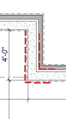

Ange822 Posted 22 hours ago Share Posted 22 hours ago Hi there, How can I move the footing dashed line so it is centered on the foundation concrete only, and not centered on the entire wall depth including the framed wall. Thank you in advanced! Link to comment Share on other sites More sharing options...

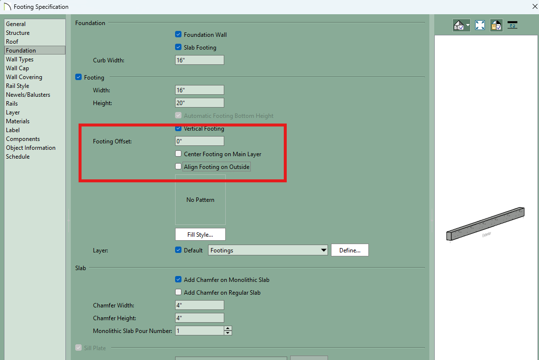

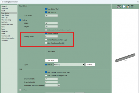

Solution tundra_dweller Posted 21 hours ago Solution Share Posted 21 hours ago @Ange822 If you go to the "Foundation" tab in your wall specs you should be able to hit the "Center Footing on Main Layer" box to get what your after. 1 Link to comment Share on other sites More sharing options...
Ange822 Posted 18 hours ago Author Share Posted 18 hours ago 2 hours ago, tundra_dweller said: @Ange822 If you go to the "Foundation" tab in your wall specs you should be able to hit the "Center Footing on Main Layer" box to get what your after. Amazing thank you!! 1 Link to comment Share on other sites More sharing options...
