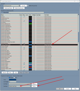

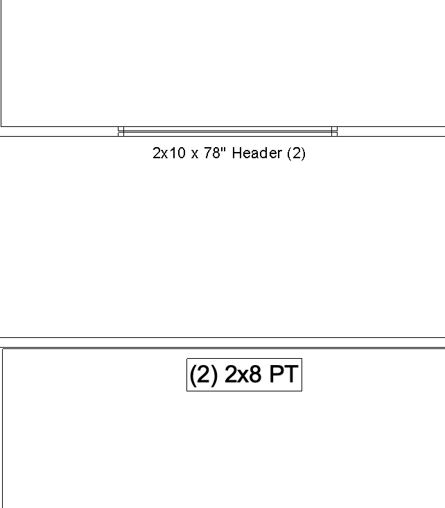

Ringos Posted October 16 Share Posted October 16 Where would one find the Header label text settings. When I go to framing specification (header) I don't see a text option but 6" arial rich text and 6" arial in the header text looks way different. I would like them to look the same. Link to comment Share on other sites More sharing options...
Ringos Posted October 16 Author Share Posted October 16 Both texts say they are the same. Yet the rich text box looks bold and much bigger. Link to comment Share on other sites More sharing options...
robdyck Posted October 16 Share Posted October 16 That is controlled by the layer and can vary from one layer set to another. You can choose a text style, re-define a text style, or create a new text style to control this display. Link to comment Share on other sites More sharing options...
