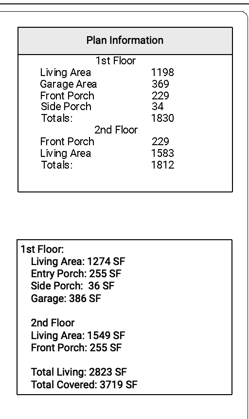

Ringos Posted October 4, 2025 Share Posted October 4, 2025 (edited) I don't really understand why there is an option for rich text and regular text. However, I decided to automate my plan square footage information using the polyline schedule methods from this When placing a schedule in layout it does not give much look option and rich text is not an option. I would like to get the text in the top box (schedule) to look like the bottom box which was the manually placed rich text. The rich text looks so much better. It's the same font same weight but looks so different. Is there a way to get schedule text to look as good as rich text? Edited October 4, 2025 by Ringos Link to comment Share on other sites More sharing options...
SHCanada2 Posted October 5, 2025 Share Posted October 5, 2025 you can format the numbers to include units in the schedule dbx. I played around with different fonts until I found one that I thought showed "good", which was Arial, I also keep everything uppercase, it looks better IMHO Link to comment Share on other sites More sharing options...
Ringos Posted October 5, 2025 Author Share Posted October 5, 2025 How did you format the numbers to include sf? Link to comment Share on other sites More sharing options...
Ringos Posted October 5, 2025 Author Share Posted October 5, 2025 GOT IT. SELECT THE UNIT INDICATOR IN NUMBER FORMATTING. Link to comment Share on other sites More sharing options...
