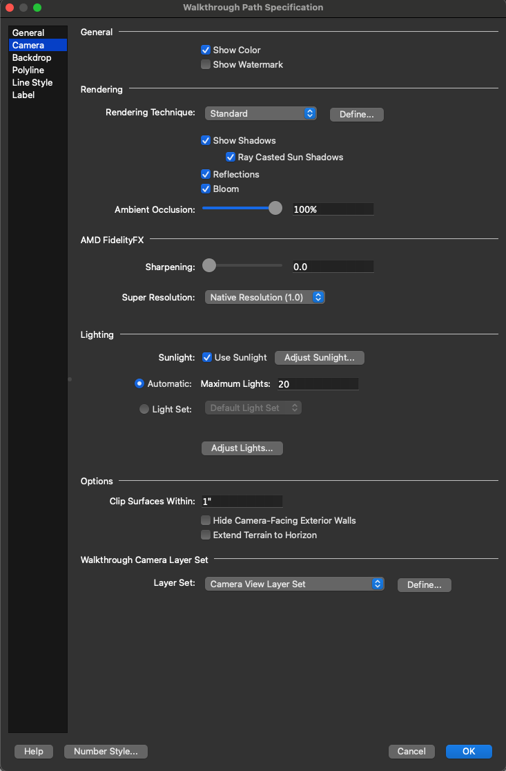

hyldahldesign Posted October 2 Share Posted October 2 Does anyone know if there is a way to change the field of view setting of a walkthrough camera? When I open up the camera settings of my walkthrough camera, it looks almost identical to a standard overview camera settings dialog box except that there is no setting for changing the field of view. Am I missing something? Is this not possible? Any suggestions on how I can do this? 1 Link to comment Share on other sites More sharing options...
Solution robdyck Posted October 2 Solution Share Posted October 2 (edited) You can only control this by changing the defaults for the Full Camera. If you preview the walkthrough, then change the defaults, then preview again, you should see the change. I should clarify: you can adjust the default with the preview open and see the change take place. Edited October 2 by robdyck Link to comment Share on other sites More sharing options...
