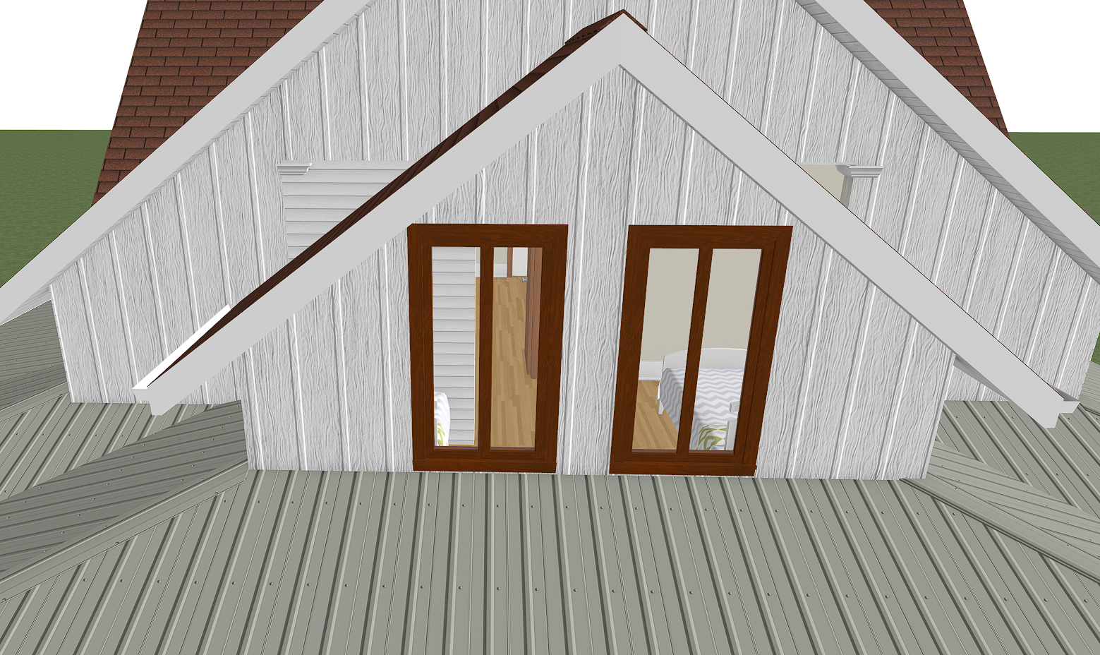

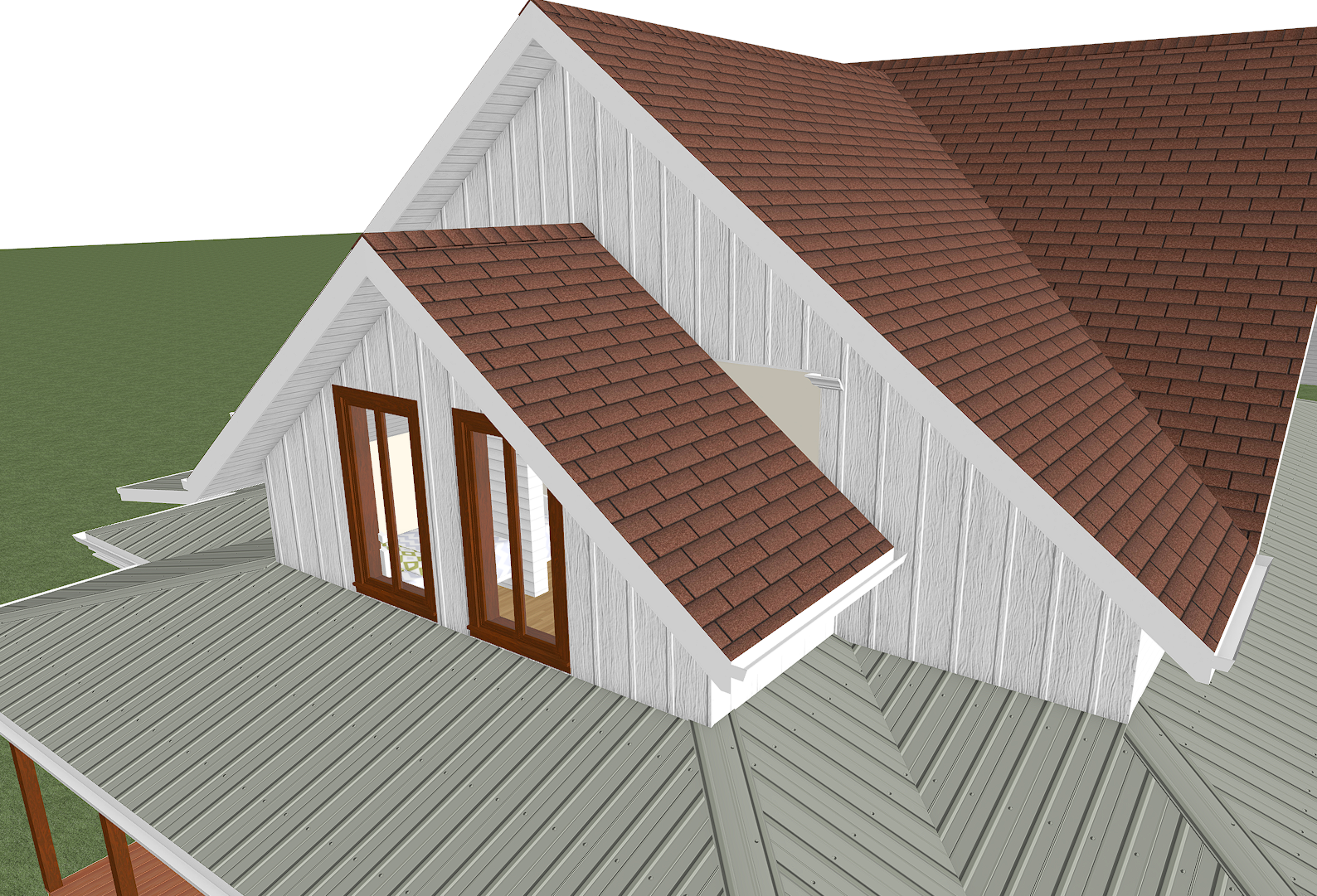

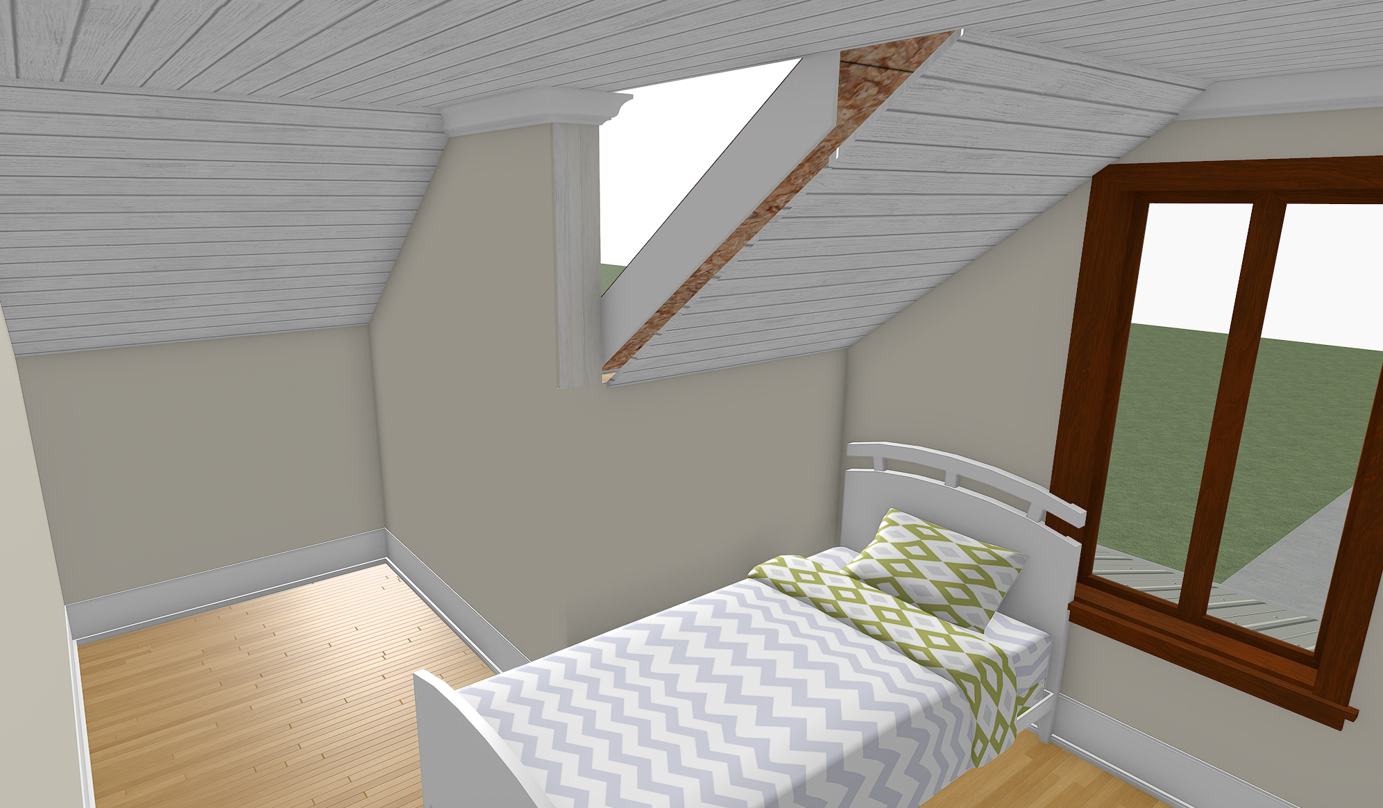

matdeslaurs Posted September 26, 2025 Share Posted September 26, 2025 Hello, I have home designer architectural. I made a room with the roof lowered in it, so the ceiling follows the roof pane. The problem is that the exterior walls don’t fill up the gap into the gabble wall. If I what it to be filled, I need to create another wall, but it appear also in the room. I know the program normally fills it automatically with an attic wall, but my situation is that I have lowered the roof and so it doesn't will with the attic wall, because it is not in the ‘’attic’’ section. Do you have any idea? Thanks! Mathieu Link to comment Share on other sites More sharing options...
Mark3D Posted September 26, 2025 Share Posted September 26, 2025 Select the attic wall under root tab select roof cuts wall below. Link to comment Share on other sites More sharing options...
