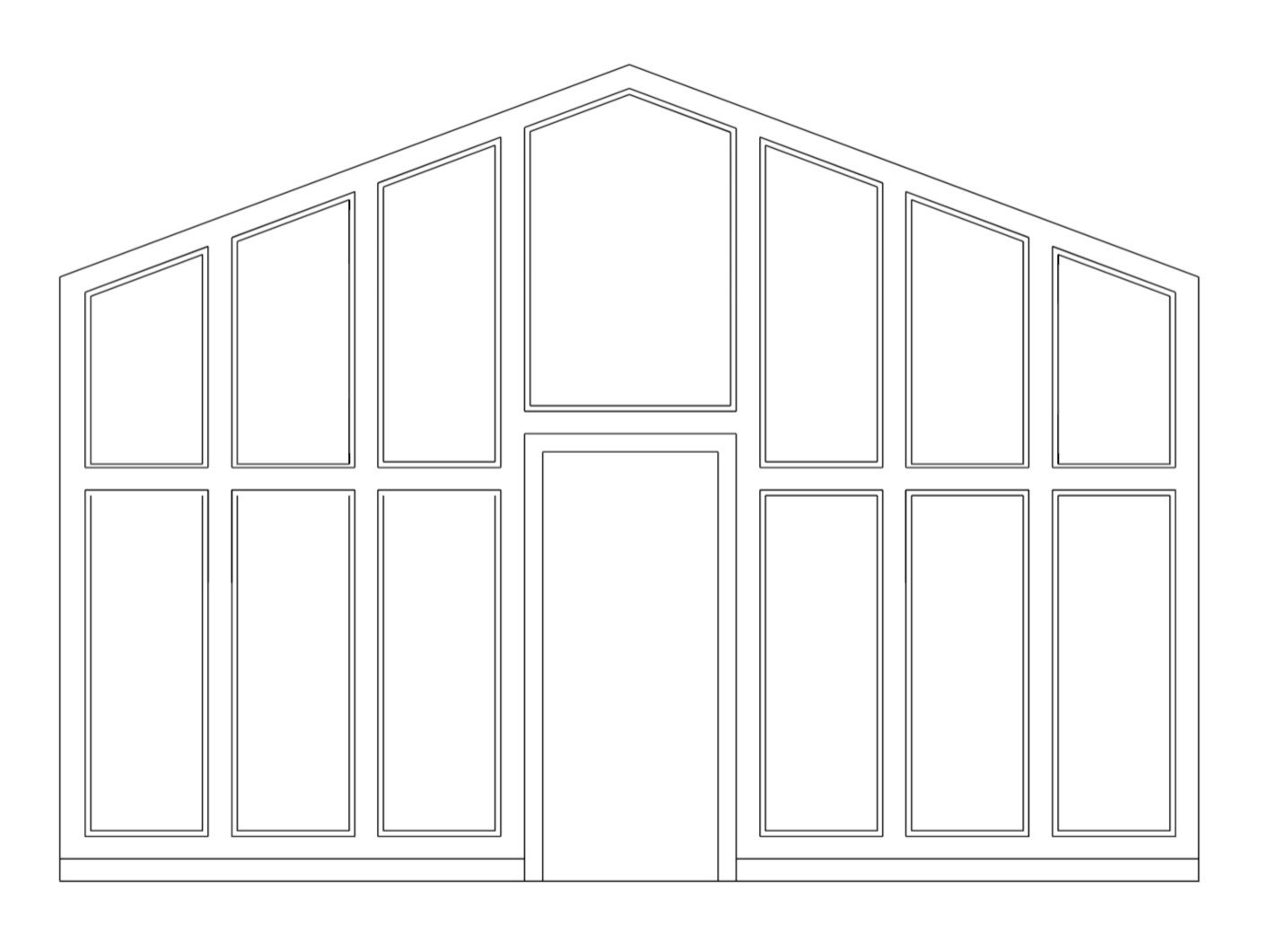

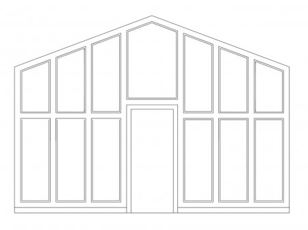

KBEDesign Posted September 16, 2025 Share Posted September 16, 2025 Does anyone know how I could create this trim wall? I have tried using molding polylines, but having a difficult time doing the angled cuts and getting them evenly spaced. Any help or advice is appreciated! I have X17. Thank you! Link to comment Share on other sites More sharing options...
DBCooper Posted September 16, 2025 Share Posted September 16, 2025 You should be able to do this using the molding tools but personally I find them a bit clunky to work with. Might be easier to use wall niches instead. Just set the wall niche to 0" deep (which will make it 1/16" for some reason) and then you can set the casing to the trim profile you want. You can even use the "match roof" setting to get most of the top row at the right angle but you will have to use something else for the middle one. You might have good luck with the "triangle arch" type. 1 Link to comment Share on other sites More sharing options...
KBEDesign Posted September 16, 2025 Author Share Posted September 16, 2025 Thank you! I never thought to use wall niches. I will give that a try! Link to comment Share on other sites More sharing options...

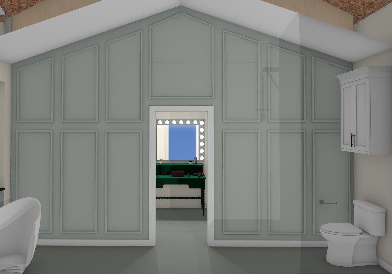

KBEDesign Posted September 17, 2025 Author Share Posted September 17, 2025 I just wanted to thank you again, that totally worked!!!! 1 Link to comment Share on other sites More sharing options...
