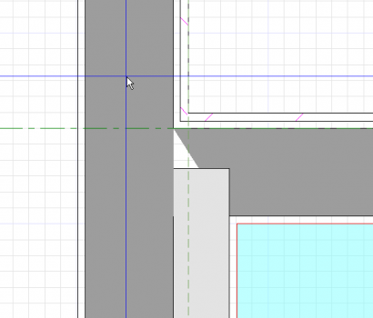

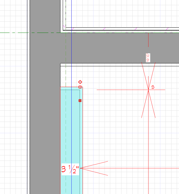

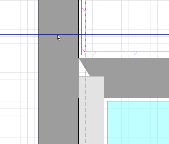

chiefUserStew Posted September 9, 2025 Share Posted September 9, 2025 Greetings Everyone, I’m new to Chief Architect and still learning the ropes. I’m running into some issues with walls on my current project. This project is an addition to an existing structure. On the original house (built in 1967), there’s a 2x4 wall that runs parallel and adjacent to a 2x6 wall from the garage (which was added in 1990). I’m struggling to figure out how to properly connect these two walls without running into problems. I cant exstend the 2x4 wall all the way to the corner. Any advice or guidance would be greatly appreciated. Thanks! Link to comment Share on other sites More sharing options...
SHCanada2 Posted September 9, 2025 Share Posted September 9, 2025 you can paste screenshots directly into the comment. I cannot see your pngs. But there are two ways to have parralel walls which are right next to each other. Make the inside wall "no room definition" in its properties, or ii) make a wall that has both walls in in it. Check the help or this forum for "furred wall" Link to comment Share on other sites More sharing options...
