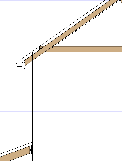

PaulBlay Posted August 30, 2025 Share Posted August 30, 2025 Hi Could someone tell me how to cut the external cavity wall so it is lined up with the soffit? Currently the external wall is cutting through the rafter. TIA Link to comment Share on other sites More sharing options...
MPDesign Posted August 30, 2025 Share Posted August 30, 2025 Paul, My first guess is that the roof baseline is not over the wall main layer. Second is the wall default top height has been changed. Best to post a stripped-down copy of the plan for best answers. Also what version of Chief are you using? Link to comment Share on other sites More sharing options...
