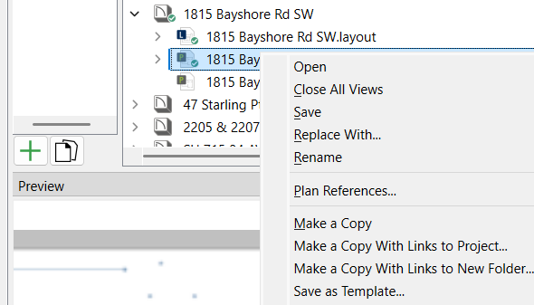

SHCanada2 Posted August 29, 2025 Share Posted August 29, 2025 4 hours ago, Veteranhands said: -5th is sort of a file/project management question-under your main project heading you have the different plan views and there's a kitchen and bath-in the project management seminar Scott shows how you can create new folders and he has several additional Kitchen folders-why would i need to do this? How would i do this? I understand that i right click, select new and then name it but then what? Do i select new plan from there? If I selected new plan how would i get my kitchen shell and dimensions to work from? I'm not sure I fully understand the question, but one reason for a new plan under the same project, is to create different options. Typically I will do the current as built condition, save that, and then make copies of that for different floor plan options. I do not see why one would want to create a brand new plan for an existing project Link to comment Share on other sites More sharing options...
Veteranhands Posted August 29, 2025 Author Share Posted August 29, 2025 12 hours ago, SHCanada2 said: I'm not sure I fully understand the question, but one reason for a new plan under the same project, is to create different options. Typically I will do the current as built condition, save that, and then make copies of that for different floor plan options. I do not see why one would want to create a brand new plan for an existing project Jason That was basically my question. When I right click on the main folder it gives me the option to create a new plan, create a new folder or to make a copy. Let's say I want to create a separate folder for the kitchen, how would I create that while maintaining only the shell of the kitchen to work from? Link to comment Share on other sites More sharing options...
SHCanada2 Posted August 29, 2025 Share Posted August 29, 2025 4 hours ago, Veteranhands said: That was basically my question. When I right click on the main folder it gives me the option to create a new plan, create a new folder or to make a copy. Let's say I want to create a separate folder for the kitchen, how would I create that while maintaining only the shell of the kitchen to work from? if you are using project manegment mode, click on the plan file, right click for the shortcut menu and then click make a copy Link to comment Share on other sites More sharing options...
