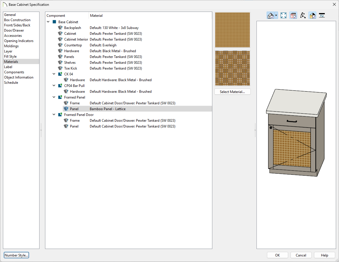

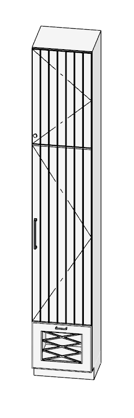

jennwhaley Posted August 26, 2025 Share Posted August 26, 2025 I am trying to add mesh to the bottom drawer of this mudroom cabinet. This is the best I've been able to come up with - any thoughts on how to do it better? Link to comment Share on other sites More sharing options...
DBCooper Posted August 26, 2025 Share Posted August 26, 2025 (edited) The bamboo lattice might look ok. I just assigned it to the panel material below. Really depends on the look you want and where you want it to look good. Textures show up in render views and patterns show up in line drawings. You can make adjustments to either depending on what you want. Edited August 26, 2025 by DBCooper 1 Link to comment Share on other sites More sharing options...
