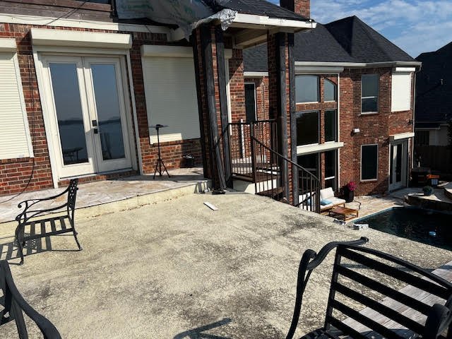

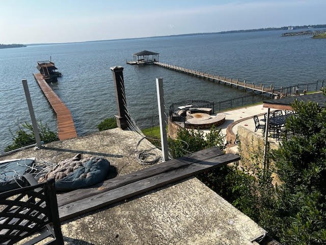

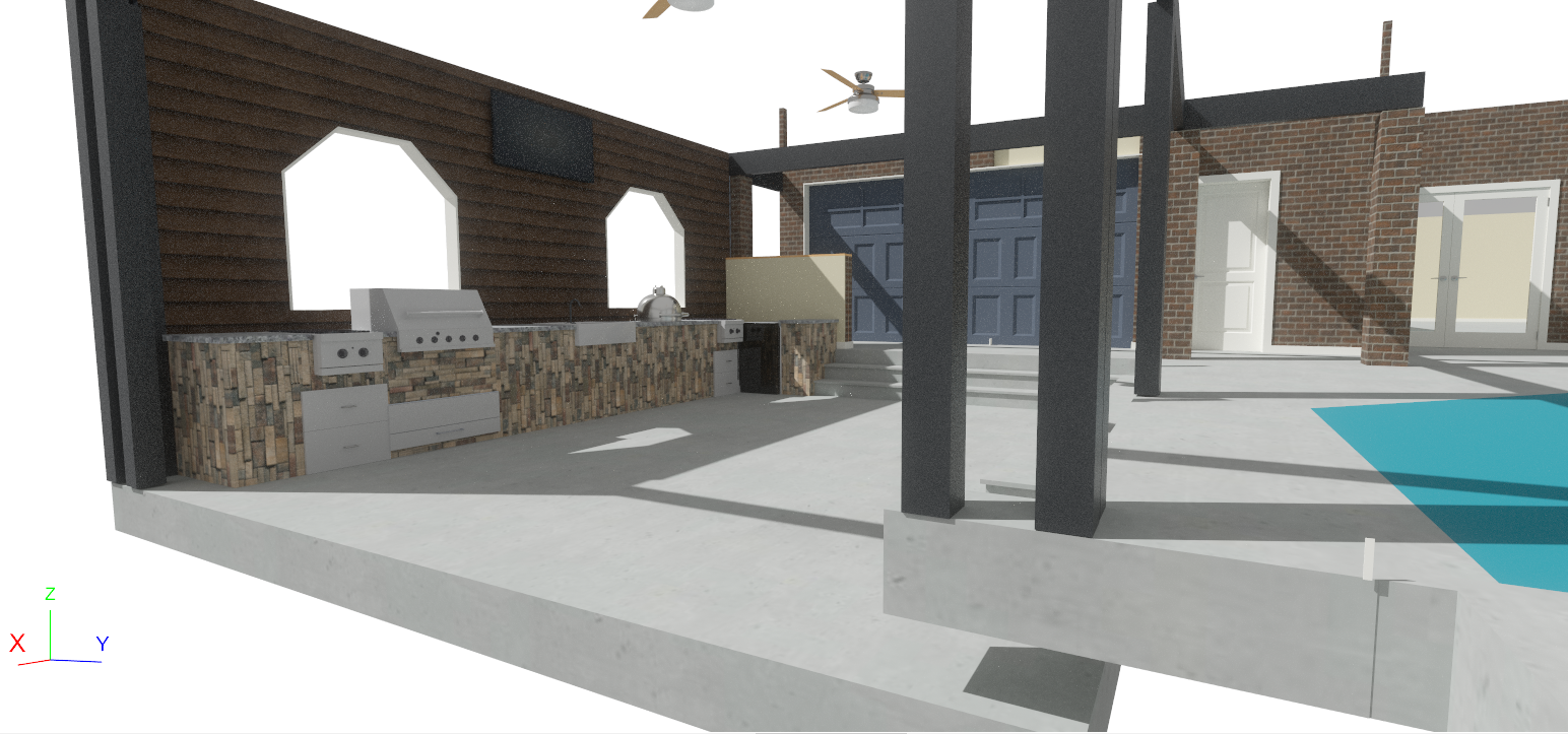

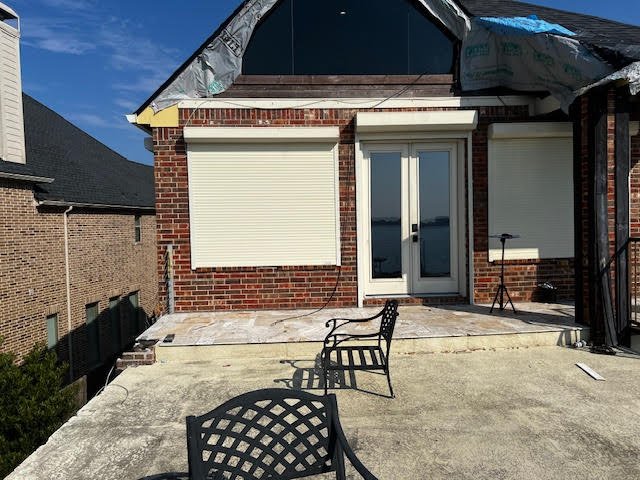

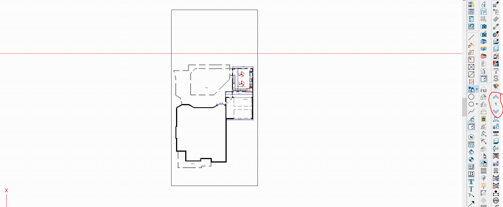

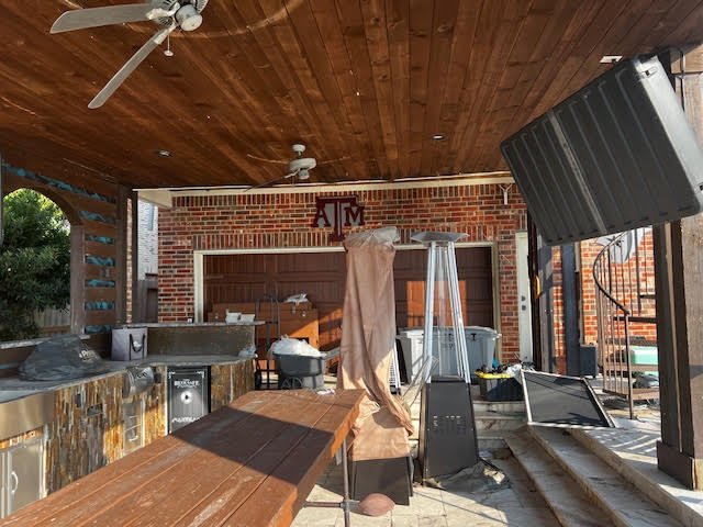

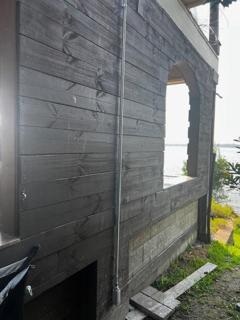

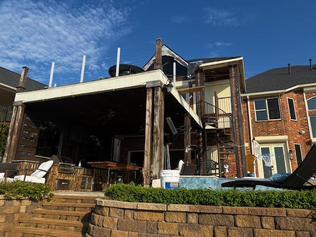

Chiefnewell Posted August 26, 2025 Share Posted August 26, 2025 This is just a remodeling of drawing back existing as is. Wind hit it, and the roof was removed on the 2nd level above the outdoor kitchen and room. 1) The stone under the BBQ and sink is not going vertical 2) 1st floor drawing on 0 level. Cannot move to the 1st floor. Outdoor Kitchen and outdoor room existing and needs a deck and partial roof on the 2nd floor level with partial roof. 3) 3 corner posts need to be set on the concrete level of the pool. Can the slab be moved to accommodate it? Floor Plan.zip Link to comment Share on other sites More sharing options...
Garybills Posted August 27, 2025 Share Posted August 27, 2025 (edited) Try using the Edit Area, copy everything on floor 0 and paste hold position to page 1, then delete everything on page 0. 3D solid to extend the concrete under the post. On the stone I opened each cabinet, selected material, selected the stone and opened it then closed it, and it changed. Well after I posted this, I noticed some of the stone changed back to horizontal. Edited August 27, 2025 by Garybills Link to comment Share on other sites More sharing options...
