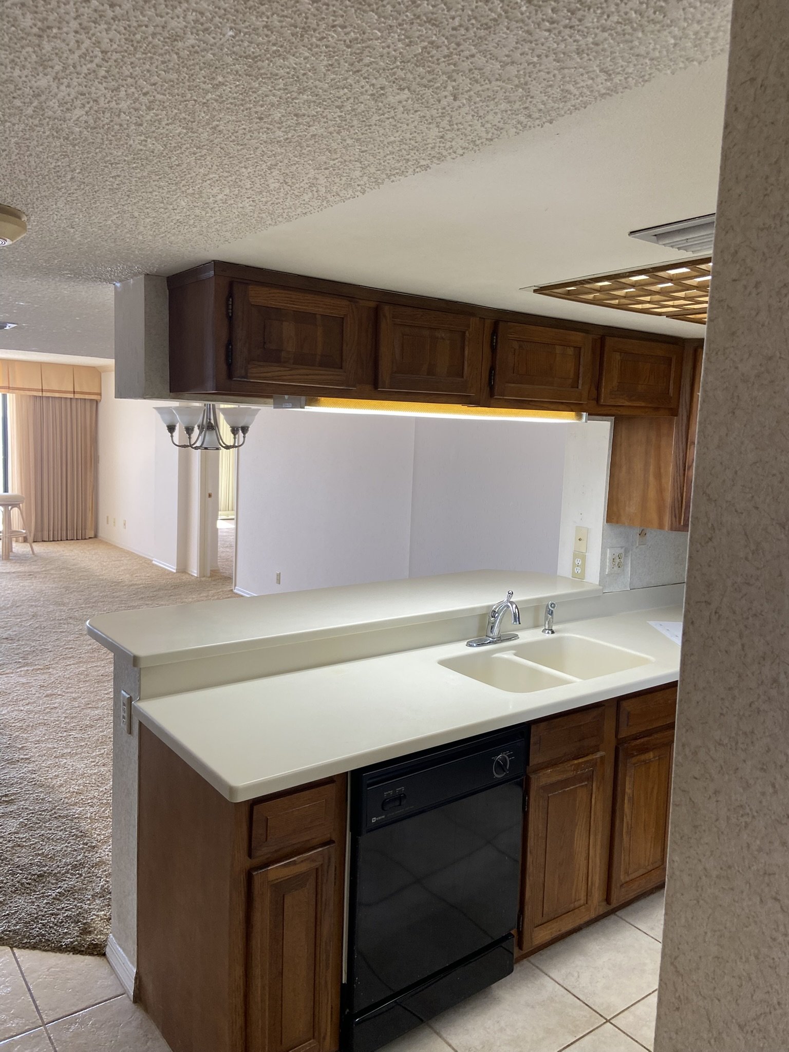

Hi all, I am trying to place some outlets on the ends of two walls in a remodel project, see first pic for real world location. I am unable to get them to snap to the ends of the two walls you see in the second pic, end of a 9 1/4" thick 40 1/2" H half wall & end of a 9 1/4" thick interior frame wall. Any way to do this easily? Thanks.

Thank you kindly. Made it work by unchecking wall mounted & choosing mounts below wall cabinet. Don't know why I didn't see that before. Thanks again, Joe.
