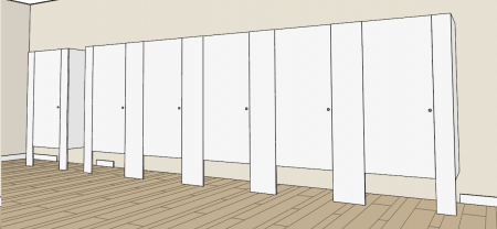

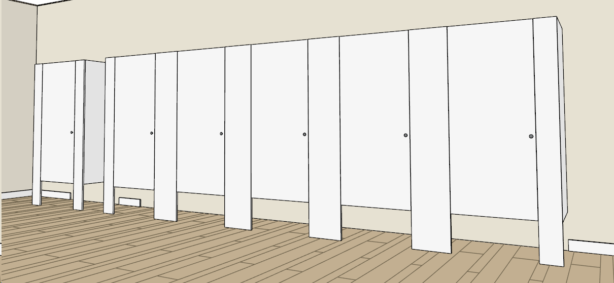

WW2Architect Posted August 20, 2025 Share Posted August 20, 2025 I am looking for recommendations or examples of commercial bathroom stalls. Especially standard free-standing panels that 'float' 12" above the floor and are 48 to 60" high. Material are sheet metal, both sides, inclosed edges. Where enclosed a floor to ceiling brace and hinged door of same style. I've defined a wall that is the correct materials and thickness but getting it to stand on its own, not be floor to ceiling is a challenge so either a wall object isn't the way to go or I need some advice on how to achieve the requirements. Link to comment Share on other sites More sharing options...
MarkMc Posted August 20, 2025 Share Posted August 20, 2025 Do with cabinets. stalls.zip 2 Link to comment Share on other sites More sharing options...
