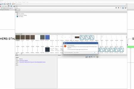

MikeR1969 Posted August 14 Share Posted August 14 (edited) Just searching for "anchor" in the library when I got this message...see attached. Edited August 14 by MikeR1969 Link to comment Share on other sites More sharing options...
DBCooper Posted August 15 Share Posted August 15 My guess is that it is a problem with the video card driver you are using. Might even be the same issue as in this post: Link to comment Share on other sites More sharing options...
KTFBGB Posted August 19 Share Posted August 19 Hey Mike, Grant from High Caliber. Fancy seeing you here. Same issue, besides rolling back the NVIDIA driver 2 versions now, have you had any luck resolving the issue? I have other stuff I run that needs the most current drivers and reinstalling the old drivers every time I fire up Chief, sucks. Link to comment Share on other sites More sharing options...
EdwinB Posted August 20 Share Posted August 20 FYI Looks like the Nvidia drivers issued on August 19 (9581.08) And today's great update from CA. All graphic-driven problems from the last couple of days should be fixed. Turned my "ENABLE GPU RENDERING" option back on. Running great again. 1 Link to comment Share on other sites More sharing options...
