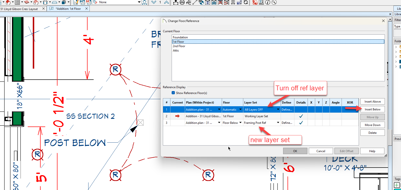

MDuffett Posted August 14 Share Posted August 14 Hello - Does anyone have any tricks on the best way to show a framing post on both the roof framing plan (floor 1) and the floor framing plan (floor 0)? Link to comment Share on other sites More sharing options...
Doug_N Posted August 14 Share Posted August 14 1. copy the post and past in both plans (works but screws up material counts, although you can exclude one copy from the schedules) 2. set up a special layer set that only shows the posts, and use that layer as a reference view for the floor level that doesn't show the posts.(that is an old trick for stairs and other features as well) 1 Link to comment Share on other sites More sharing options...
MDuffett Posted August 14 Author Share Posted August 14 Thank you Doug. I typically use the first suggestion but I will try the second. I am slowly working on using the material list so I would like to keep it as clean as possible. Link to comment Share on other sites More sharing options...
Doug_N Posted August 15 Share Posted August 15 (edited) The second method is pretty simple, you add a new reference view. Edited August 15 by Doug_N Link to comment Share on other sites More sharing options...
