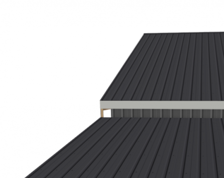

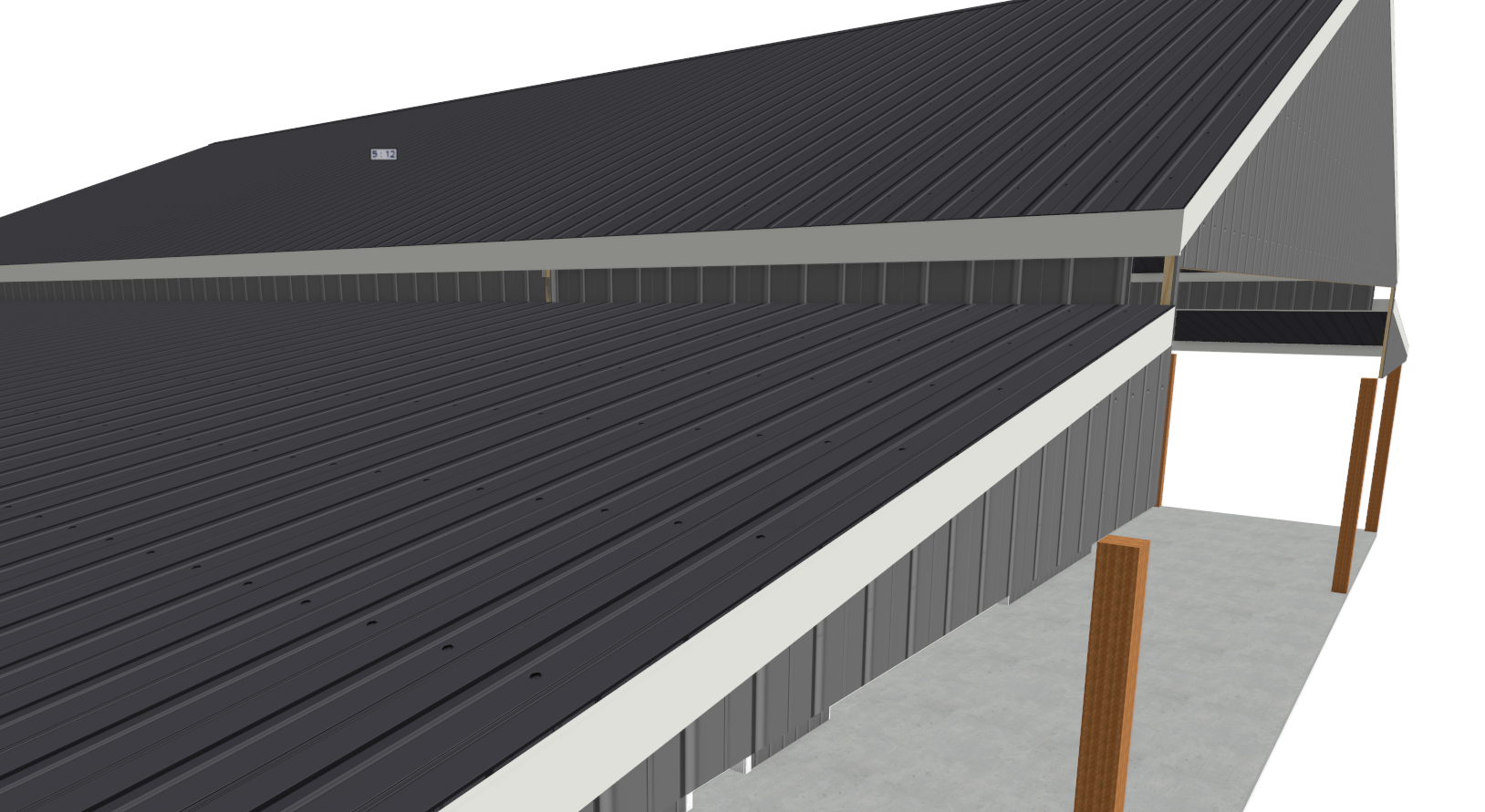

GrizzL Posted August 13 Share Posted August 13 I am using invisible walls to achieve the roof extensions and lean to's on this build. The gap looks to be from the invisible front wall intersection. What is the best practice for filling in this gap in these walls? I resorted to creating a custom wall to use and manually edited the wall from the floor up. Is there is a way to do this with auto generated walls or is it a manual job that I haven't figured out yet? Love.plan.zip Link to comment Share on other sites More sharing options...

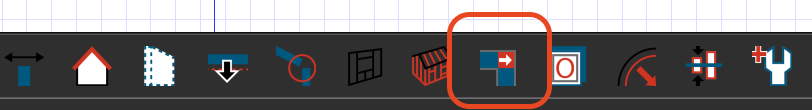

PitMan71 Posted August 13 Share Posted August 13 Try clicking on that wall and using the "edit wall layer intersection" tool. It might allow you to pull the galvalume layer over ignoring the intersection. 1 Link to comment Share on other sites More sharing options...
Solution Michael_Gia Posted August 13 Solution Share Posted August 13 3D Solid + paint with same material. Get used to doing this on a regular basis and have layers assigned to those 3D solids so they only show up where you want to see them. I have a layer called "_Healing Solids" because my 3d models always seem to be missing flesh. 1 1 Link to comment Share on other sites More sharing options...

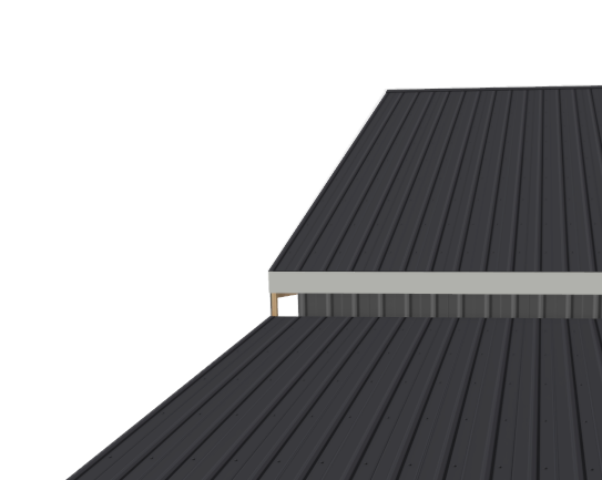

GrizzL Posted August 13 Author Share Posted August 13 Thanks for the tip Shane! I wasn't familiar with that tool yet. Unfortunately it didn't work but now I do know about its usefulness. I've never used 3D solids either but they worked like a charm. I'm going to name them healing solids as well Michael that does seem fitting. Thx! 1 Link to comment Share on other sites More sharing options...
