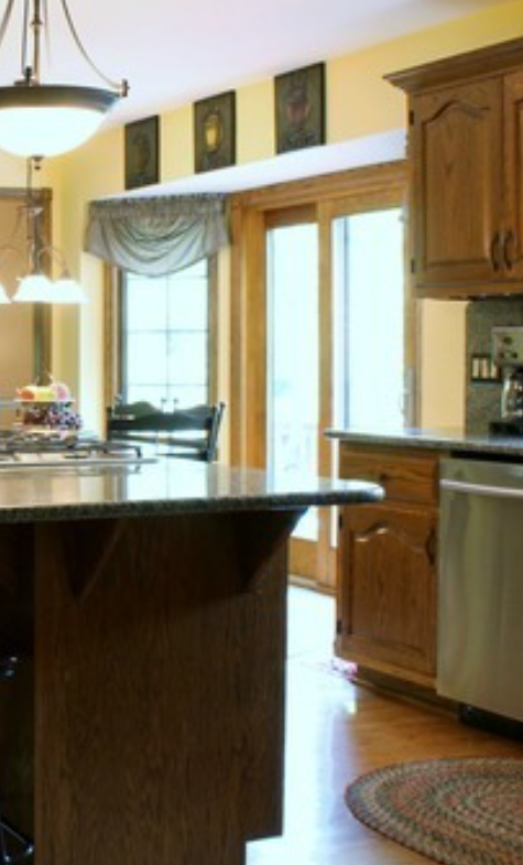

DVIJD2 Posted Sunday at 09:11 PM Share Posted Sunday at 09:11 PM What is the most efficient way to draw the attached Bay windows with sliding patio door and soffit? Any advice would be greatly appreciated. Link to comment Share on other sites More sharing options...

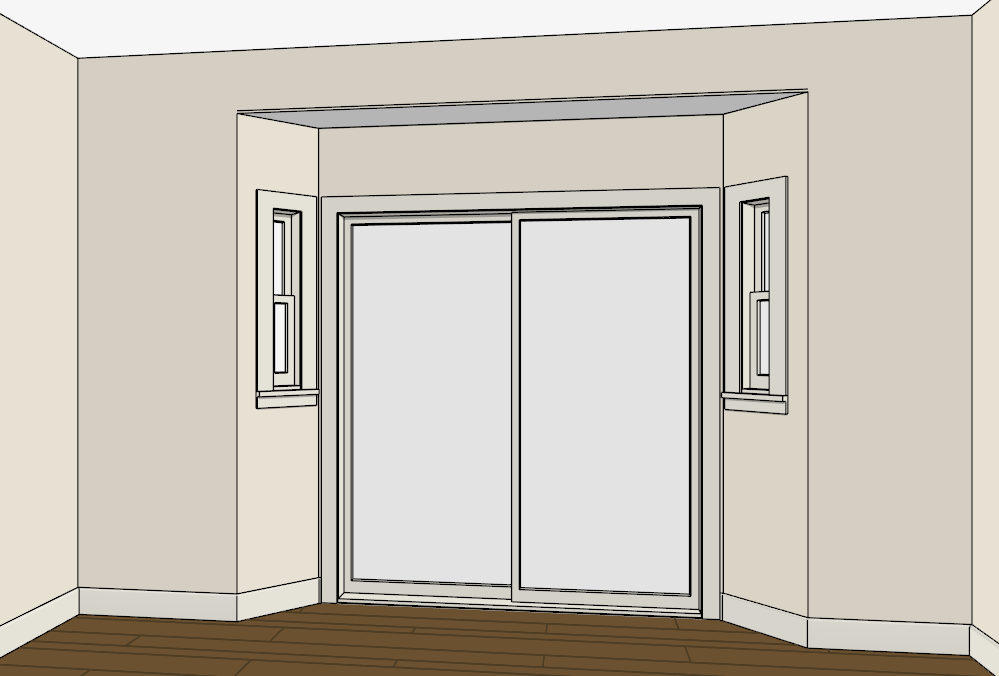

Solution DBCooper Posted Sunday at 10:36 PM Solution Share Posted Sunday at 10:36 PM You could use an auto bay window and then just make the window a slider. Setting "has lowered ceiling" will give you the soffit. Just tab to select the window and change it from the default type into a slider and then lower the bottom to the floor. See pic below. If you need it to show up in the schedule and material list as an actual door instead of a sliding window, then you could explode the bay window and then replace the window with a sliding door. 1 Link to comment Share on other sites More sharing options...
DVIJD2 Posted Monday at 06:24 PM Author Share Posted Monday at 06:24 PM Thank you very much! I will give this a try. Link to comment Share on other sites More sharing options...
