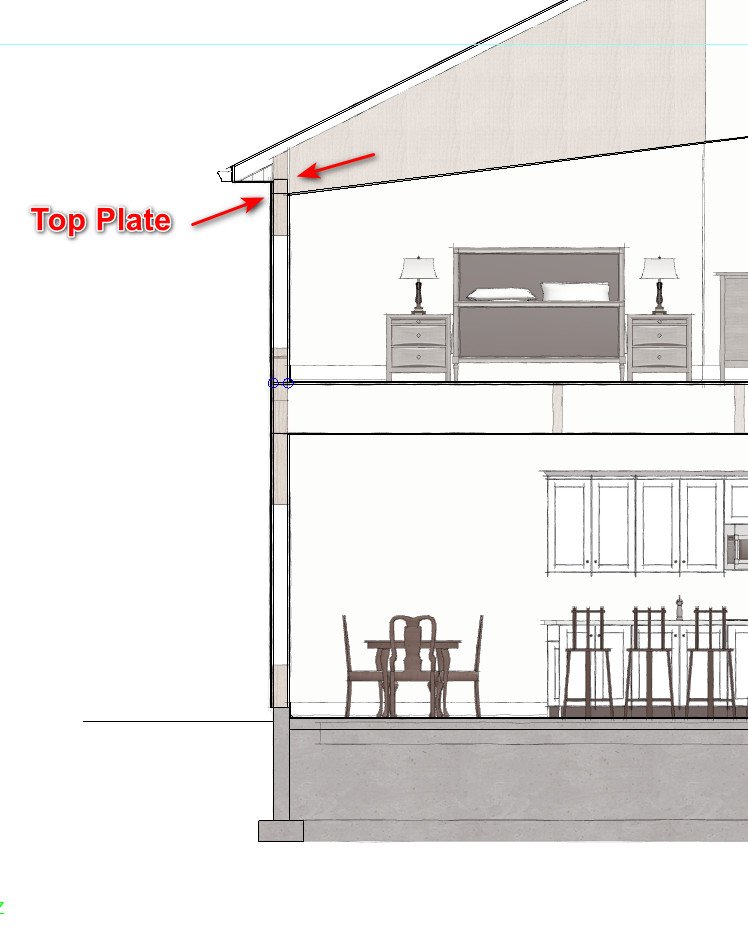

Steve_Nyhof Posted July 18, 2025 Share Posted July 18, 2025 This has driven me crazy for years. I set my top plate to 5'-10 5/8", and yet I have this extended wall that when walls are added, it puts on a double, double top plate... Plan https://drive.google.com/file/d/1Z6qTE_o1odZ4mgvV1zPKWrDvzXyg7L25/view?usp=sharing Thoughts? Thank you Steve Link to comment Share on other sites More sharing options...

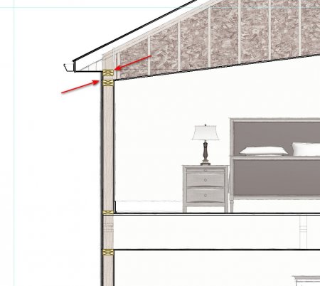

robdyck Posted July 18, 2025 Share Posted July 18, 2025 The upper plates are from the attic wall which is building using a gable wall framing method...studs on the plates below with 2 top plates. For truss roofs, we rarely need framed gable walls. You can either delete all the attic wall details or replace the attic walls with a customized attic wall that doesn't have any framing layers. Link to comment Share on other sites More sharing options...
robdyck Posted July 18, 2025 Share Posted July 18, 2025 With auto wall framing, there is no way to override this during design development ans Chief auto builds attic walls matching the walls below. During plan completion, I turn off auto wall framing and I either replace the attic walls with my own gable wall or I delete all the attic wall details form the project browser. I have a few gable wall types to match cladding thickness of siding, stone, and brick. Link to comment Share on other sites More sharing options...

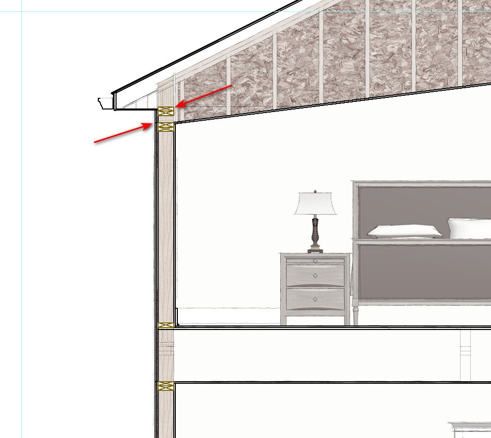

Steve_Nyhof Posted July 18, 2025 Author Share Posted July 18, 2025 Thank you, Robert! That makes sense. I have deleted the walls from the attic on occasion, but sometimes it is not at clean as this plan. Seems to me we should have an option to turn off wall framing for attic walls if we want. Suggestion 20,001 Edit: If you have attic walls generated from a main floor roof and also from a second floor roof, that is when you cannot delete the walls from the attic level, and where turning off framing for attic walls would be nice. Link to comment Share on other sites More sharing options...

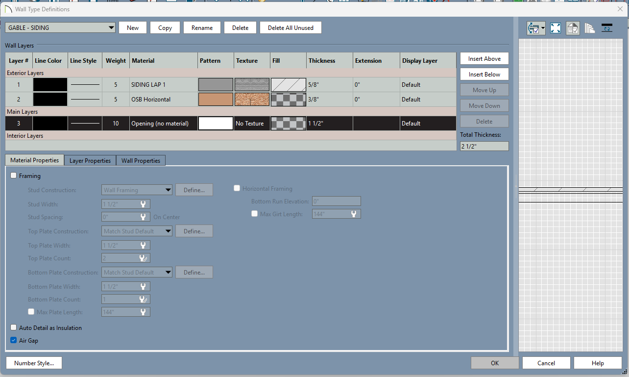

robdyck Posted July 18, 2025 Share Posted July 18, 2025 Another seemingly simple option would be for Chief to provide a default Attic Wall type. You'll notice my gable wall is setup to coordinate with a gable end truss...I also don't want 5.5" of framing, cad insulation boxes, or drywall in my trussed attic! 1 2 Link to comment Share on other sites More sharing options...
