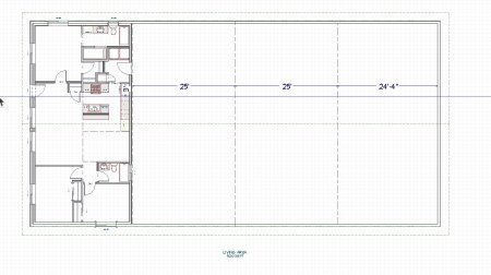

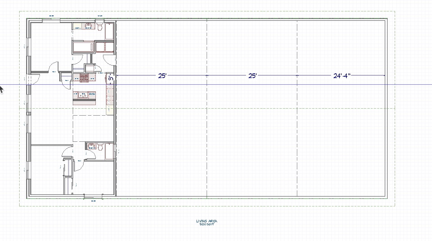

wkenddad Posted July 17, 2025 Share Posted July 17, 2025 Here's the scenario: I'm designing a framed structure that will be constructed within a free standing metal building. The Framed structure wall exterior is separated from the Metal Building interior side of the wall by an air gap of 0" When I print the Framed Structure Floor Plan I would like to make the exterior metal building walls not display. This would also go for displaying the framing of ceiling and floor, etc. In Auto CAD you can set walls to different layers such as Wall-Ext or Wall-Int. Then you can turn off the layers you don't want displayed. How is this done in CA - I'm using version X10 Link to comment Share on other sites More sharing options...
Chrisb222 Posted July 17, 2025 Share Posted July 17, 2025 6 hours ago, wkenddad said: In Auto CAD you can set walls to different layers such as Wall-Ext or Wall-Int. Then you can turn off the layers you don't want displayed. How is this done in CA The same way. You may have to create new layers to separate the walls onto, unless you already have multiple wall layers in your plan. Link to comment Share on other sites More sharing options...
