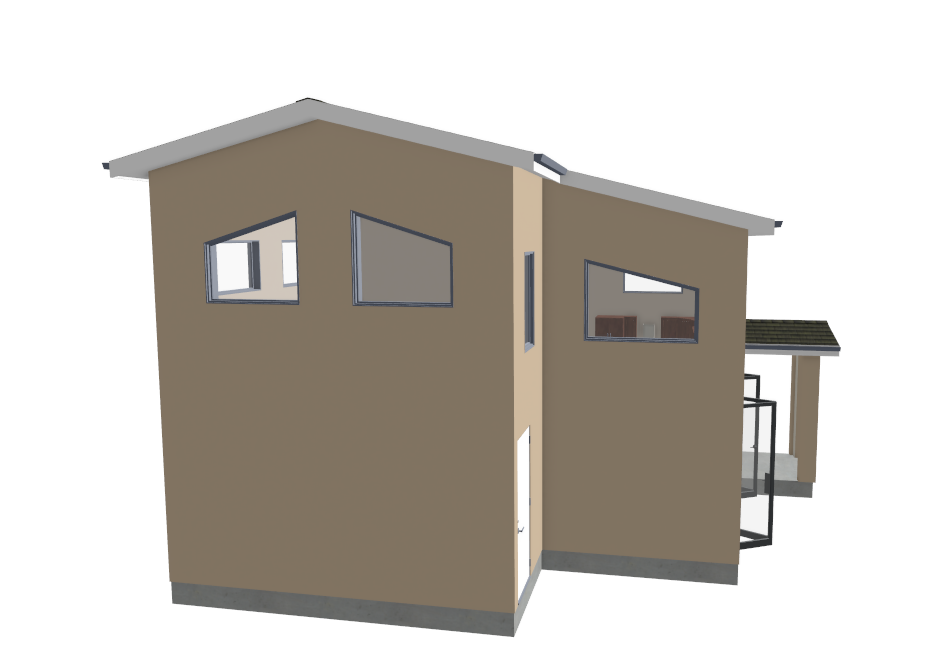

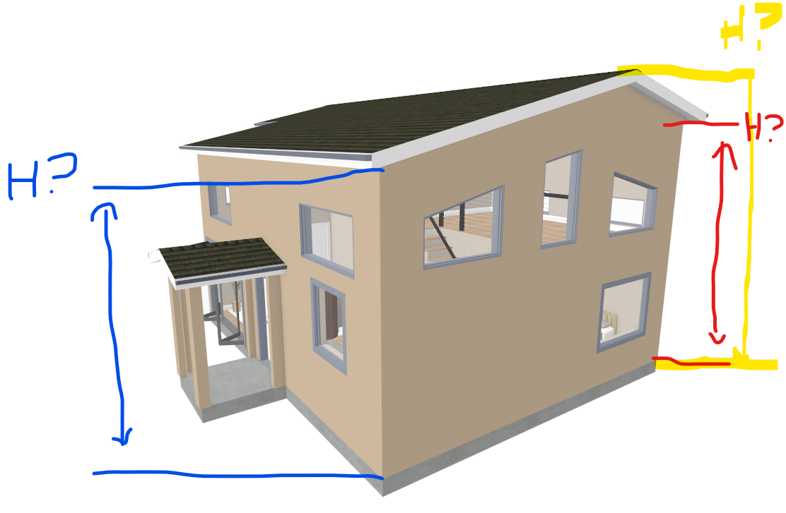

ChiefuserDYee Posted July 15, 2025 Share Posted July 15, 2025 Can anyone please help me determine these wall heights? This is an ADU of <1000sqft. I am required to have a maximum roof height of 16ft and a 3/12 roof pitch to match the main building. When I select any wall, it's broken down into two or three sections. The roof is designed to allow the greatest headroom over the loft while still maintaining the correct roof pitch and maximum living space. I would need to change the wall heights in Chief to fit my requirements but cannot find a working solution. The design is a one-story with a loft that features a high open ceiling, but as drawn, it is closer to a two-story.. Sip wall construction for the exterior walls, slab foundation, and standard interior framing. 1st pic is E elevation, 2nd pic is W elevation, Porch faces S I am using Home Designer Suite 2025 Link to comment Share on other sites More sharing options...
Mark3D Posted July 23, 2025 Share Posted July 23, 2025 In camera view Cad Menu Automatic Dimensions Auto Story Pole dimensions or in section view draw manual dimensions Link to comment Share on other sites More sharing options...
