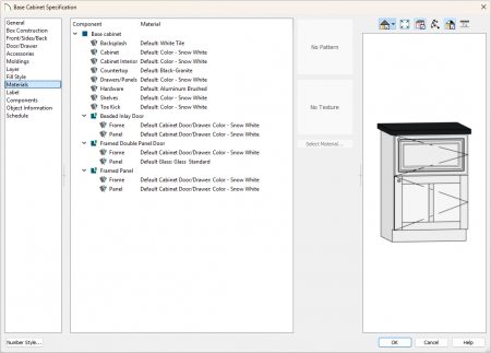

DBCooper Posted May 25, 2025 Share Posted May 25, 2025 Take a look at my picture below. It has 3 different door styles listed on the materials page. The upper door was set to the beaded inlay door. The lower door was set to the framed double panel door. The other framed panel door is the one that was set as the "main door style" for the cabinet. It's not currently using the main door style but if I was to add a new door somewhere or change one of the other two to "use default" then it would. Whether you are using the main door style or not, you can still set the materials for it. Basically, any time you use a door, drawer, or end panel style from the library in a cabinet it will then show up in the materials. How many sub-materials show up and what the names are depends on how the person that built the symbol set it up. Link to comment Share on other sites More sharing options...
