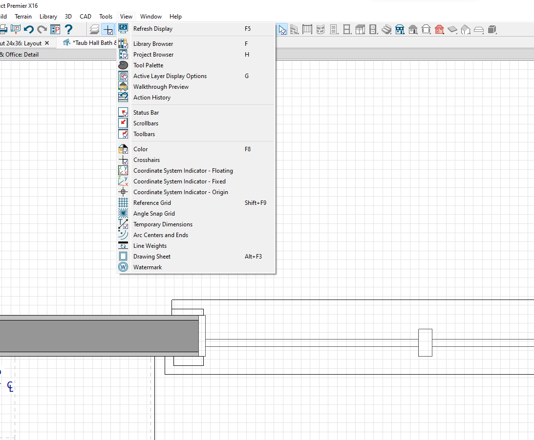

Hello! Does anyone know how to remove the zoomed-in grid from Chief's plan file?  I have the reference grid turned off, which works when I'm zoomed out. When I zoom in, there is still a grid that shows up.  I'd like there to be no grids in the drawing.
Turn off Grid Snaps:
514437798_Screenshot2025-04-23at10_59_13AM.thumb.png.1b262ac159e281fac16cf9ee978ffc34.png
Or, you can edit the Grid Snaps settings here:
1342891224_Screenshot2025-04-23at10_56_51AM.thumb.png.1f0c495f132f6eedc2941cff3e49ae71.png
There is also a toolbar toggle button for Grid Snaps on/off.
