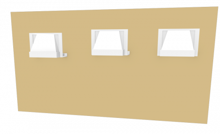

joestilwell95 Posted April 18, 2025 Share Posted April 18, 2025 I have been working on creating a custom range hood cabinet. I created it all from 3D Solids. I have several options on how I can create a symbol with it. 1. Is it better to select all of the components and create the symbol or block with them and then create the symbol. 2. I was hoping I could create the symbol as a cabinet but it looks like all I can do is specify what layer it will appear on and where it will appear on the schedule. 3. My options are to create it as a fixture or as millwork. I have tried both and the functionality seems the same with each option. Is one better to use than the other? 4. I was really hoping there was a way to create an actual cabinet so I could insert a range hood into it as I would a dishwasher in a base cabinet. It's all about the learning curve so all suggestions and experience are appreciated. Joe Molding.plan Link to comment Share on other sites More sharing options...
Renerabbitt Posted April 18, 2025 Share Posted April 18, 2025 1 hour ago, joestilwell95 said: I was really hoping there was a way to create an actual cabinet so I could insert a range hood into it as I would a dishwasher in a base cabinet. You would need to convert this to a Cabinet Door/Drawer Symbol Category and then apply it to a cabinet set with no top bottoms or sides with a 0" framed box and then you would still need to modify a hood liner to be a millwork symbol category to apply it as a shelf. Millwork shelves are not replacement mode accessible to you would always have to open the dialog box to replace the hood liner and you would have to convert a bunch of liners to millwork symbols. Pretty tedious. You could convert your hood liners to cabinet doors but this would take very advanced symbol bounding box and offset modifications Link to comment Share on other sites More sharing options...

Renerabbitt Posted April 22, 2025 Share Posted April 22, 2025 3 hours ago, joestilwell95 said: Thank you ReneRabbitt. Does sound a tad tedious but definitely worth some investigation. considering a rendering of a liner would be pretty obscure and not a common rendering by any means, it would be a lot easier to just replace your fixtures label with a macro or by typing it in for your fixture schedule material lists etc. Link to comment Share on other sites More sharing options...
