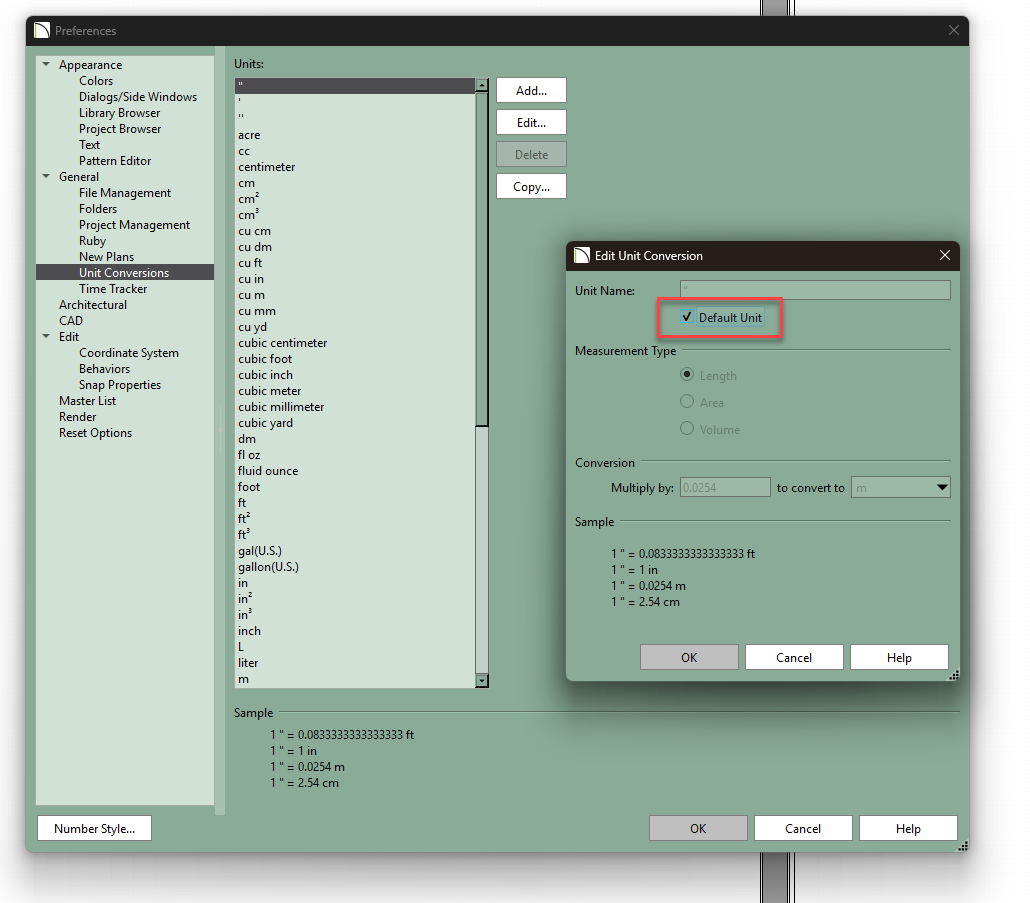

MollyNDG Posted 5 hours ago Share Posted 5 hours ago I have what feels like a silly question, but I am hoping you all can help me figure out what I am missing. In X17 macros that were reporting any measurement were doing so with the " and ' format, but in X18 i am getting IN and FT. I have a very basic understanding of macros, so I am not sure if it something I'm doing differently with them. But my suspicion is that it is a setting buried somewhere in my plan that I am unaware of. It doesn't seem to be something in text styles or number formating, so I am at a loss of where to look. In the attached plans, you can see that my room label shows the ceiling height as 96 IN, when I'd like it to say 96". Any guidance is greatly appreciated. TEMPLATE - PLAN.zip Link to comment Share on other sites More sharing options...
Solution tundra_dweller Posted 4 hours ago Solution Share Posted 4 hours ago Try going into Preferences > General > Unit Conversions and edit the ' and " units, check the Default Unit box. Link to comment Share on other sites More sharing options...
MollyNDG Posted 3 hours ago Author Share Posted 3 hours ago 1 hour ago, tundra_dweller said: Try going into Preferences > General > Unit Conversions and edit the ' and " units, check the Default Unit box. That's the ticket, thank you @tundra_dweller! 1 Link to comment Share on other sites More sharing options...
