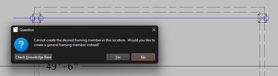

TCB_BdnMY Posted Tuesday at 08:25 PM Share Posted Tuesday at 08:25 PM (edited) Hey there folks just wondering if anyone else is running into this issue where with beams in X18. When i paste the floorplan into an clean CA template file it works fine... Any ideas what settings to check? It is doing this in pretty much every room type right now, inside or outside. Edited Tuesday at 08:39 PM by TCB_BdnMY Link to comment Share on other sites More sharing options...
Solution mLongChief Posted Tuesday at 08:51 PM Solution Share Posted Tuesday at 08:51 PM 14 minutes ago, TCB_BdnMY said: Hey there folks just wondering if anyone else is running into this issue where with beams in X18. When i paste the floorplan into an clean CA template file it works fine... Any ideas what settings to check? It is doing this in pretty much every room type right now, inside or outside. Are your floor/ceiling platforms set to build with trusses? There is a known bug with Floor/Ceiling Beams when trying to create them when all the Floor/Ceiling Structure (the specific room you're building in, and the defaults) are set to build with trusses. Assuming you're running into that bug, it should be fixed in the next update. In the meantime, you could temporarily change you Floor Structure to build with Joists, draw your beams, then turn your Floor Structure back into trusses. 2 Link to comment Share on other sites More sharing options...
TCB_BdnMY Posted Tuesday at 09:23 PM Author Share Posted Tuesday at 09:23 PM it was exactly this! Thank you. Link to comment Share on other sites More sharing options...
