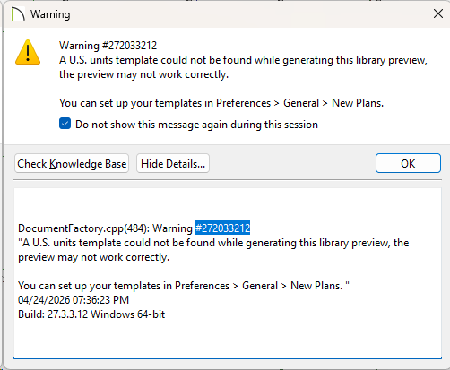

jwflowersii Posted April 25 Share Posted April 25 Anyone else getting this error since upgrade? Link to comment Share on other sites More sharing options...
CarrieS Posted April 27 Share Posted April 27 Tech Support sees that occasionally if you're not using Chief Architect Project Management and your data folder is on a cloud like OneDrive. Here are some articles that might help: https://www.chiefarchitect.com/support/article/KB-03132/resolving-unexpected-behavior-on-a-windows-pc-by-redirecting-the-data-folder.htmlhttps://www.chiefarchitect.com/support/article/KB-03125/troubleshooting-error-messages-associated-with-the-program-s-data-folder.html If you continue to have trouble I recommend contacting our Technical Support team. They'll be able to dig in with you to figure it out. https://www.chiefarchitect.com/support/#contact Carrie Link to comment Share on other sites More sharing options...
