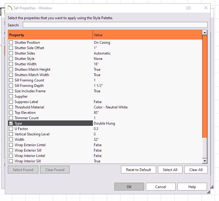

Frenchy1 Posted yesterday at 12:58 AM Share Posted yesterday at 12:58 AM I have added some of my custom library objects to some custom toolbars I've made, but would like to have it so when you click them, they use the object painter mode. For example, say if I have an awning window and I want to change it to a double-hung window, I click the double-hung window icon in my toolbar, and it paints instantly over the awning automatically without having to add the window to my plan first, then use the object eyedropper to pick it, then spray it over something. Is this just possible or am I just making stuff up Link to comment Share on other sites More sharing options...
MarkMc Posted 2 hours ago Share Posted 2 hours ago This belongs in Q&A section. Style pallets work well for spraying. Link to comment Share on other sites More sharing options...
