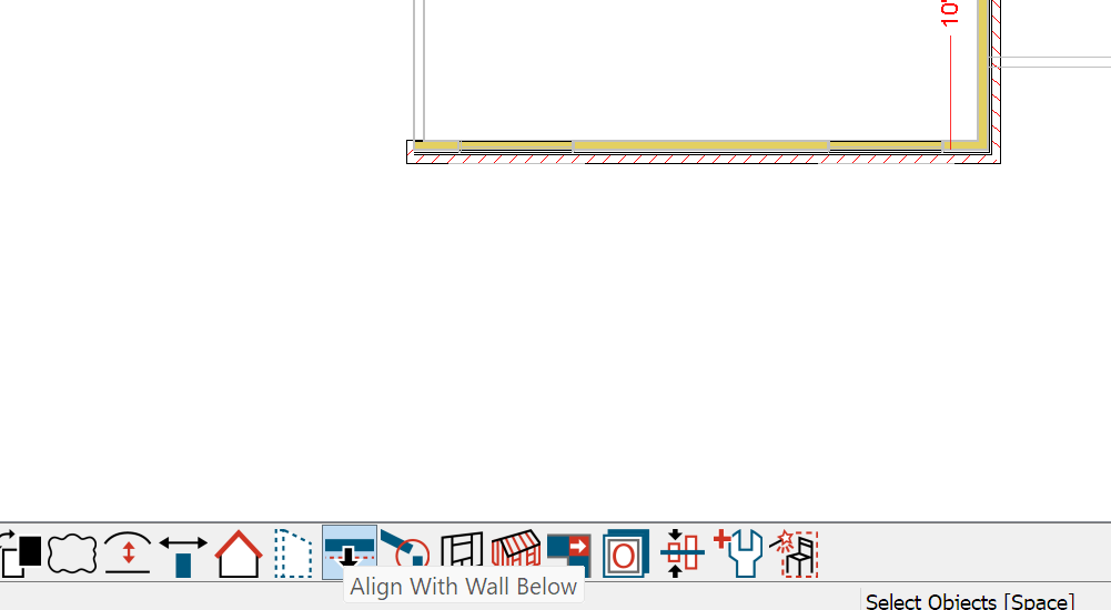

GHArchitect Posted March 7 Share Posted March 7 I am a novice user of CA 16 and have created working view plans where somehow the first floor is shifted 1/8" to the right of the basement and second floor plan. How do I get these back in alignment and be sure that all relevant layers are also shifted? Link to comment Share on other sites More sharing options...
rwdozier Posted March 7 Share Posted March 7 Select your wall and align with wall above or below. Link to comment Share on other sites More sharing options...
