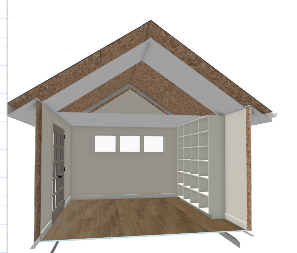

jacpdx Posted February 25 Share Posted February 25 Hi, I am attempting to draw a portion of the ceiling in this plan vaulted, the rest flat. I think I figured most of it out, but I don't know how to build the interior gable wall where the vault meets the flat. Guidance is much appreciated. Plan is attached. I used "Export Disconnected Plan"; let me know if that is not the correct method. Thanks, John Studio.plan Link to comment Share on other sites More sharing options...
Solution javatom Posted February 25 Solution Share Posted February 25 Draw a wall in the attic that aligns to the flat ceiling plane. Click on the wall and define it as an attic wall. That should do what you are looking for. Link to comment Share on other sites More sharing options...
jacpdx Posted February 25 Author Share Posted February 25 I think that worked, had some issues getting it drawn... but it looks like its there now. Thanks! Link to comment Share on other sites More sharing options...
