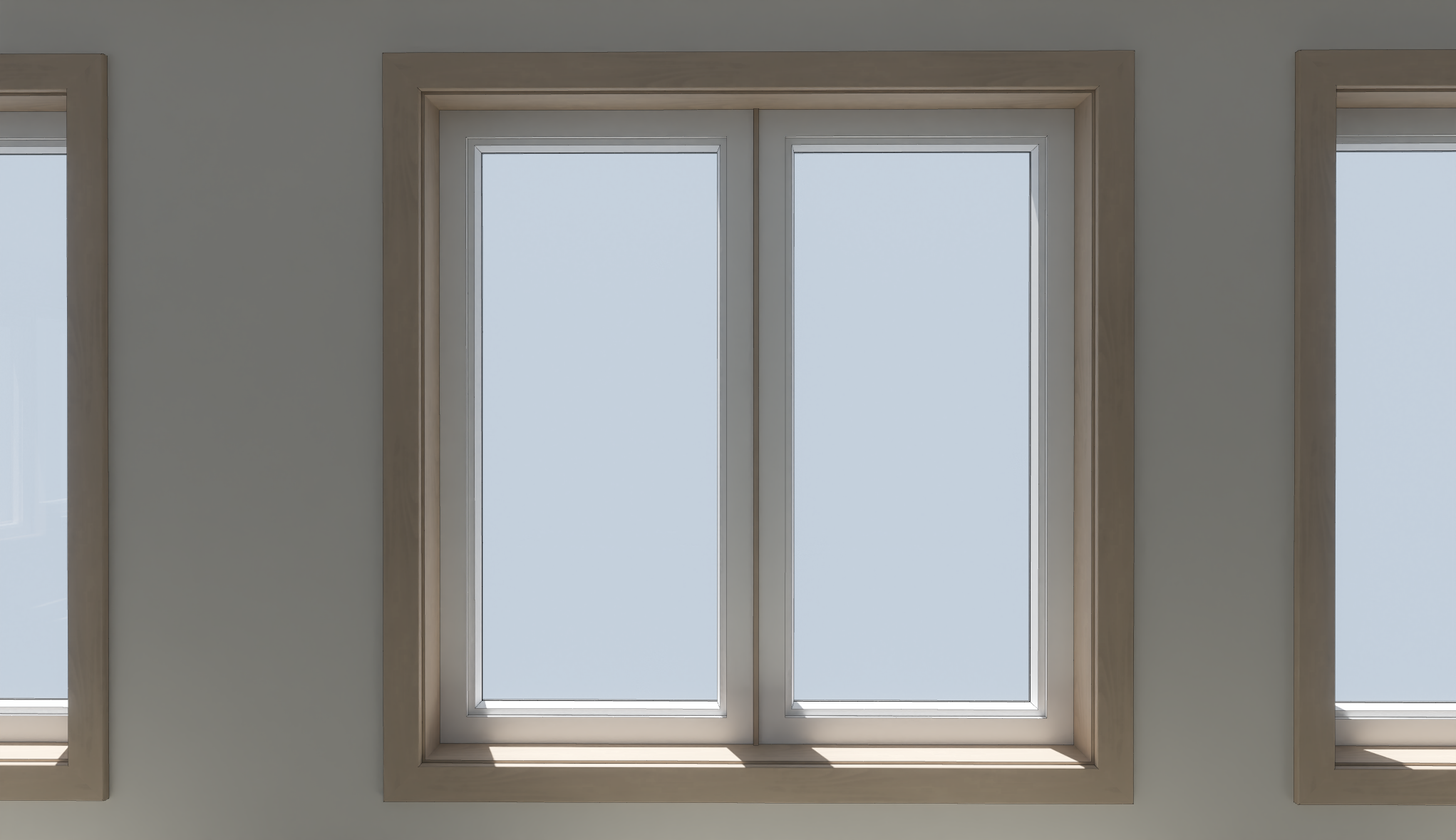

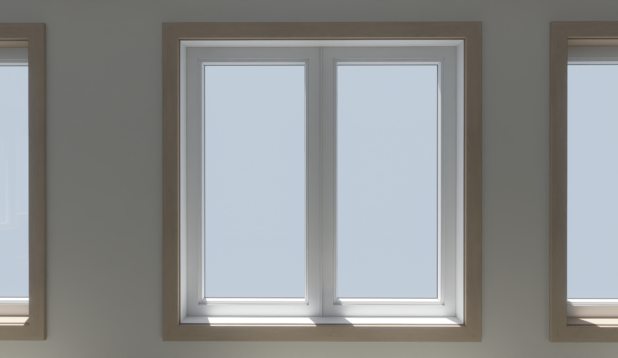

JonathanK Posted February 18 Share Posted February 18 Am I missing something, or is there no way to call out extension jambs on windows? Also, I'm trying to build windows specific to how our manufacturer makes them (within reason of course), and the windows in general feel like they're missing a lot of adjustments that would make it model correctly. The biggest thing I notice is that we have adjustments for sash and frame, but if you look at how a casement window is actually built, there is overlap there that is not possible with how Chief models the window. Meaning on the exterior of a casement window you see more of the "sash" and less of the "frame". On the inside, it's the other way around. Is this a big deal?...no not really. But I want my cake and eat it too. Link to comment Share on other sites More sharing options...
JonathanK Posted February 18 Author Share Posted February 18 Another bummer, is when I want wood trim and "extension jamb", it makes my mull strip in the middle wood as well. That's pretty lame. Link to comment Share on other sites More sharing options...
