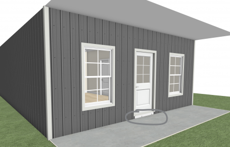

winterdd Posted January 28 Share Posted January 28 Any reason why this happens in X17 at door bottoms? Never seen it before when I input doors and it show the house wrap. Link to comment Share on other sites More sharing options...
PitMan71 Posted January 28 Share Posted January 28 This is a good question. As I recall X16 did it too, but for me it looks fine until I build the foundation. Is that the case here? 1 Link to comment Share on other sites More sharing options...
winterdd Posted January 28 Author Share Posted January 28 8 minutes ago, PitMan71 said: This is a good question. As I recall X16 did it too, but for me it looks fine until I build the foundation. Is that the case here? Thanks Shane, it worked by building the fdn on this home but not on others. I will troubleshoot. Link to comment Share on other sites More sharing options...
PitMan71 Posted January 28 Share Posted January 28 You can always just add a sill to the door. Link to comment Share on other sites More sharing options...
winterdd Posted January 28 Author Share Posted January 28 1 hour ago, PitMan71 said: You can always just add a sill to the door. Will do! Link to comment Share on other sites More sharing options...
