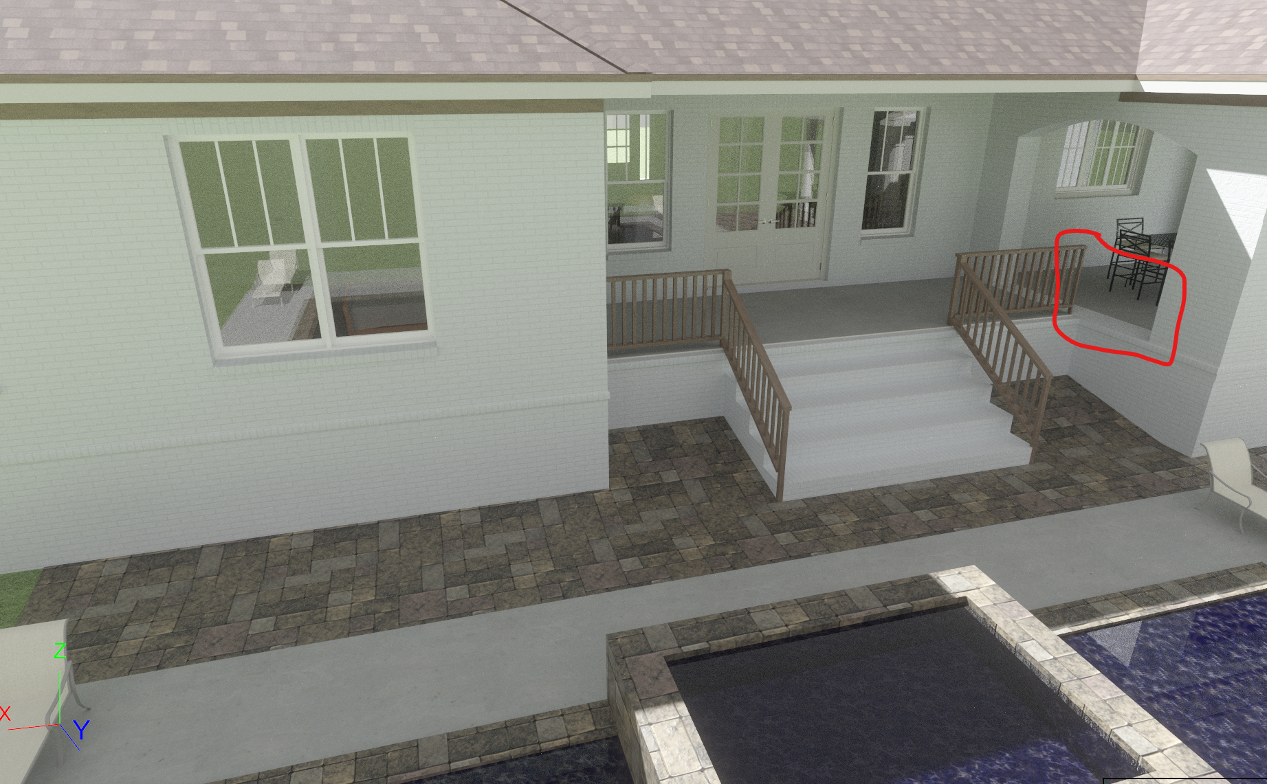

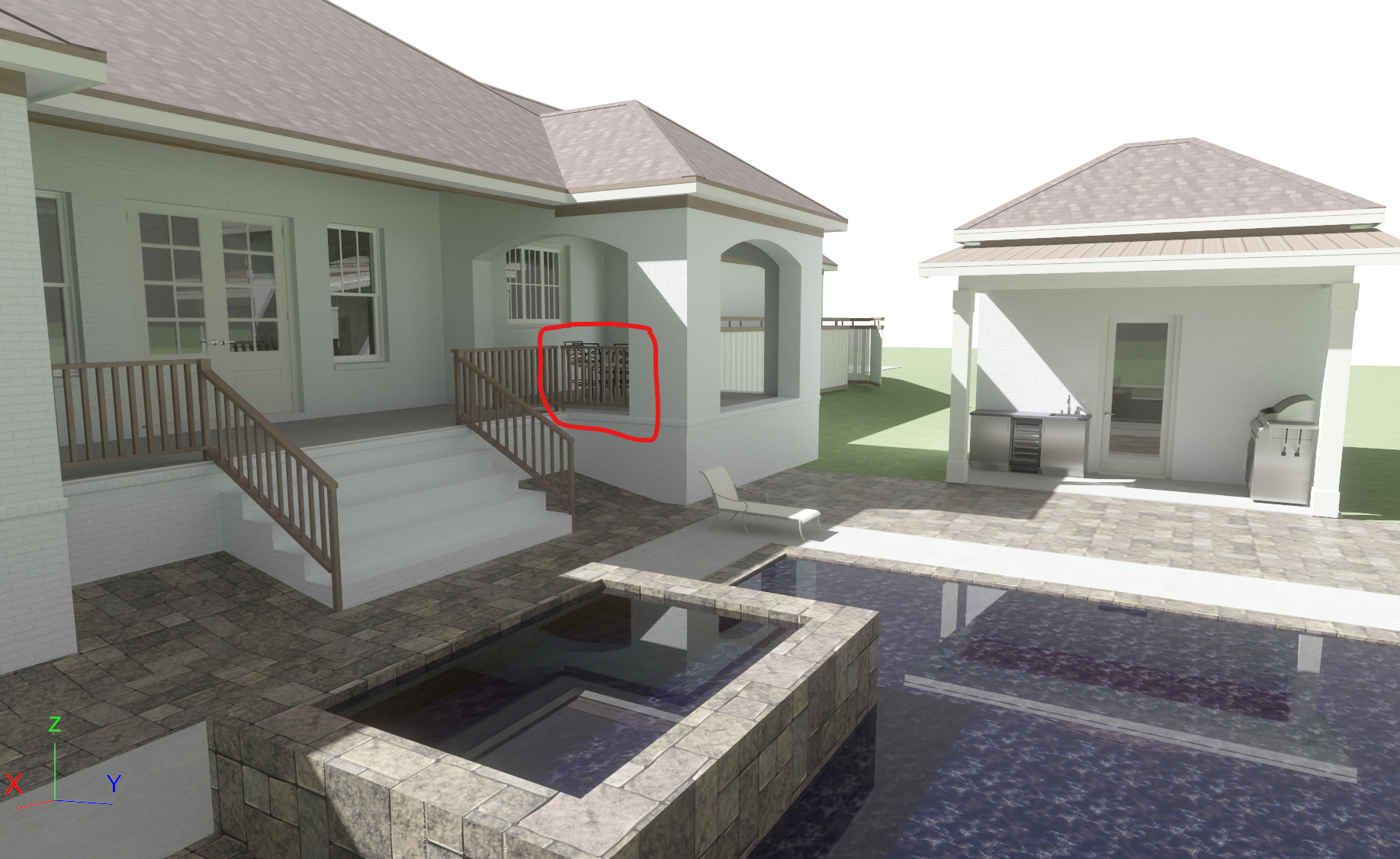

winterdd Posted 2 hours ago Share Posted 2 hours ago (edited) Well, I tend to go months without having questions and it seems in the past 3 days I am getting several hiccups. I need to add a railing to close off this area below. Those openings are doorways with the trim removed. Besides manually drawing polyline solids is there a way to draw a railing wall without throwing the opening into chaos? Edited 2 hours ago by winterdd Link to comment Share on other sites More sharing options...
ChiefTylerL Posted 2 hours ago Share Posted 2 hours ago Hello @winterdd, This kind of design can be created by drawing a railing and marking it as No Room Definition. Here is a Knowledge Base article that will outline the process: https://www.chiefarchitect.com/support/article/KB-00919/placing-a-railing-in-a-doorway.html I hope this helps! 2 Link to comment Share on other sites More sharing options...
winterdd Posted 1 hour ago Author Share Posted 1 hour ago 1 hour ago, ChiefTylerL said: Hello @winterdd, This kind of design can be created by drawing a railing and marking it as No Room Definition. Here is a Knowledge Base article that will outline the process: https://www.chiefarchitect.com/support/article/KB-00919/placing-a-railing-in-a-doorway.html I hope this helps! It's always something so simple to fix, thanks! Love it....... 1 Link to comment Share on other sites More sharing options...
